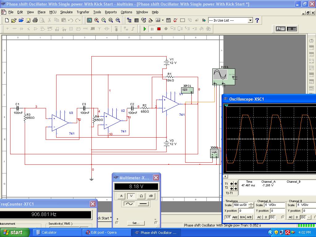

Thanks Hero. now Last thing is that, this attached circuit is using dual power supply. can you tell how can i use the same circuit with a single Power supply without affecting other parameters.?
It's possible.
I would replace the three 741s with a TL084 which has four decent quality op-amps on one chip rather than using three separate poor quality op-amp ICs.

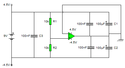

The fourth op-amp would be configured as a virtual earth. I would connect it as a non-inverting unity gain buffer with a potential divider set to half the supply voltage as the input and the output connected to all the 0V nodes in the original circuit. You will need to add an AC coupling capacitor to the output of the oscillator.
I'll post a schematic if you're not sure.
yes.please post me the schematic.
Here's a simple virtual earth.
If you replace the 9V battery with 12V, you'll get a +6V and a -6V rail. connect the 0V to the 0V parts of your schematic and the + and - 6V to the positive and negative respectively. Obviously the output voltage will be halved.

Ordinary opamps cannot oscillate in your circuit at 200kHz.
The max frequency for a 741 opamp is 9kHz and the max frequency for a TL084 opamp is 100kHz.
Where did you get 200kHz from? The attachment says 907Hz.
In post #19 the OP thinks his oscillator can go from 1Hz to 200kHz.
"ok. now with this I've Completed my Phase shift Oscillator. which is for low Freqencies (i think from 1Hz to 200KHz)."
At 200kHz the max output of a 741 opamp is only 1.5V p-p and its gain is only 4.
Hey! i was talking generally about phase shift Oscillator that this Oscillator is used for low frequencies about 1Hz to 200KHz.
Audioguru is correct, you need to use a high speed op-amp with a full power bandwidth of at least 200kHz.
200kHz is actually quite a high frequency for an op-amp.
