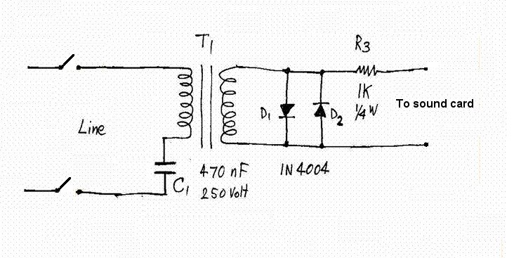

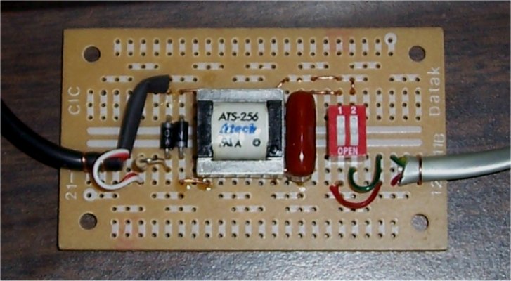

I made this adaptor using parts from a old modem card. The schematic, wich I am very thankfull for, is from ljcox, a forum member:
https://www.electro-tech-online.com/threads/help-converting-speaker-phone-to-line-level.26988/#post191400
I must say that I am very happy with the way it is working. It is not picking up any noise or interference even if it is very near a few computers and other equipments. But I used a good quality and well shilded (stereo) cable as output to he sound card .
I am using Voice E-Mail Pilot, a freeware, as recording software. This software has the ability to stop recording when there is no activity on the line.
