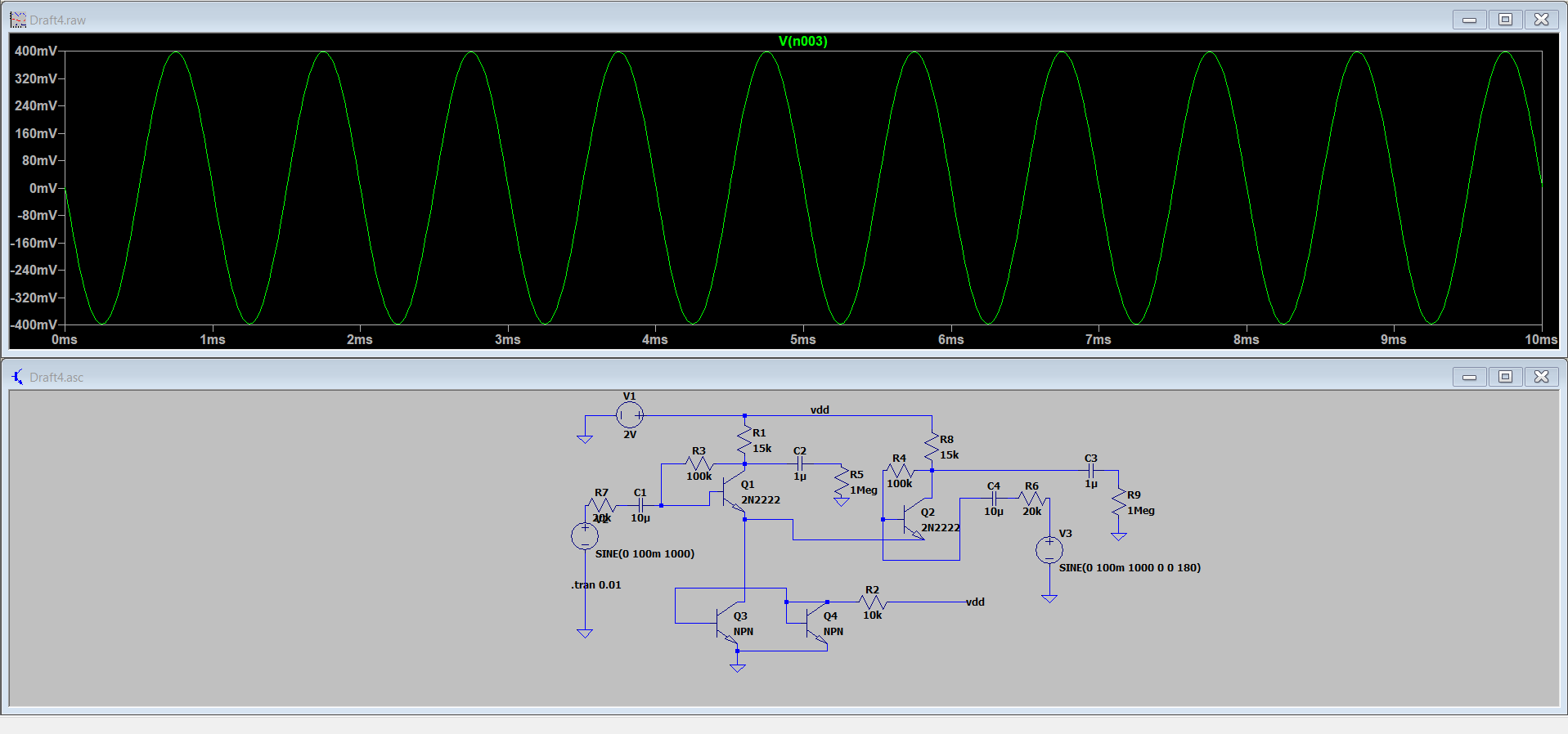

When I checked the output of this capsule It was peaking about 100mV. Since I technically don't need additional gain with my sound card I can keep the gain low on the diff amp and focus on getting good CMMR. I immediately realized it wouldn't be possible to amplify 100mV signal with a amplifier that had no feedback since it would clip to a nice square wave. So I used some feedback to both increase input resistance and decrease the gain to something about 4 with 20K input resistors. If I find a 22k double pot for example I can make the gain adjustable on both inputs and maybe even make it be useful for dynamic mics that require much more gain. I do have 1M double pots so maybe tapering (putting parallel resistor with pot) could work?
For now with no input resistors to decrease gain it gets about 35 times max gain. CMMR is about 50dB which is more than enough. Current consumption is quite low about 250uA at 2V so hopefully sound card output will be able to feed it. I messed around with values a little and found something like this is ideal.
It works well with different input voltages. I am aware that I can replace bottom right transistor with a voltage divider and if I build this in real life I may make it with a trimpot for better adjustment. Load resistors can be replaced with PNP transistors to perhaps increase open loop gain but as it is I find it satisfactory.

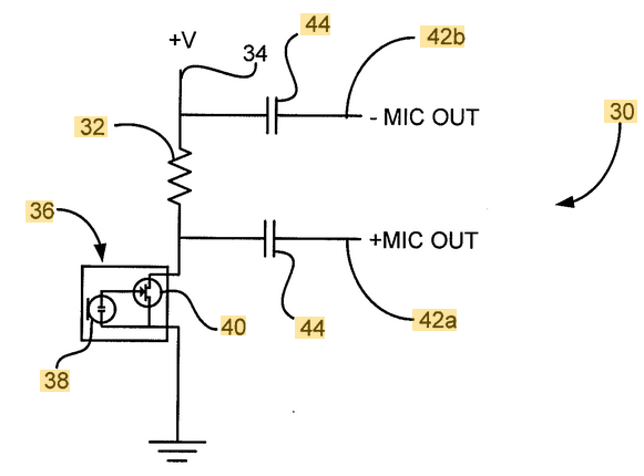

How will I get differential output from electret mic.
I saw this and I wonder if I can pick a resistor value to get something I can apply at the two inputs. Or can I use two electret microphones to get two similar signals. But if I used two mics that gave the same output it would be cancelled by the differential amplifier so one of them would need a 180 degree phase shift. Can these problems be relieved?
Second is getting the output. Should I use one of the differential outputs like a single ended output. Or should I have another circuit to convert differential to single ended output? I think I am only losing gain if I do the first one.
I think for making this work with a dynamic mic which requires about 200 times gain I would need PNP transistors or another stage too boost the gain. At that point I would have litteraly made a bad op amp that tolerates low voltages.

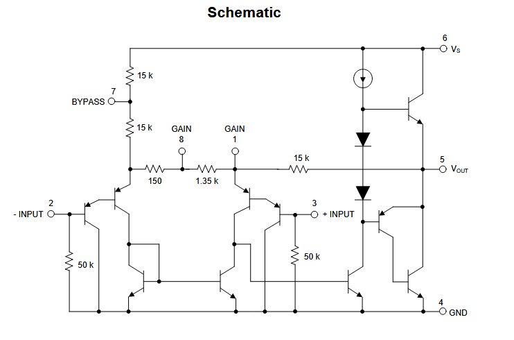

LM386 looks similar at the input side ignoring the darlington pairs. I started seeing differential amplifiers everywhere after learning about it. Are they they useful?
