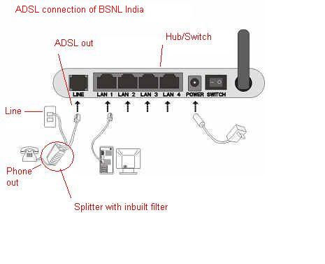

Yea this special one we have in India. Its a DSL/phone inbuilt filter and splitter(confused? Take the words on their meaning). DSL goes to modem and Phone goes to phone directly. We don't use any external filters.
In any case, y can't u connect your modem directly into the incoming line without any splitter/filter have net access and give it a ring and check??
Go outside and hang on the line using modem,cellphone and a laptop.

Don't know what you use over there?, but here ADSL filters have one input, and two separate outputs (using different sockets) - one ouput is low-pass filtered, and feeds the phone, the other is high-pass filtered and feeds the ADSL.
Each phone in the house has a filter feeding it, fltering the HF ADSL signal out, and the ADSL modem has one feeding it, filtering out the LF audio and ringing tone.
An alternative is to have just ONE filter, directly where the phoneline comes in, and fed all the phones in the house off the phone output of that single filter, and the modem off the ADSL output from it.
I use a combination of both - the incoming line is split two ways - one way goes to an ADSL filter and feeds all the telephone sockets in the house, the ADSL output is unused. The other output of the splitter feeds directly to my attic (where I am now), and where another ADSL filter is used, to feed both the modem and a phone next to it, just because the phone output was there, and it saves me walking across the room to where the normal phone socket is :D
So I've got just two filters, for six phones and one modem.
Yes, that is different then here. They give us simple external DSL filters (they gave me five with my kit) here that have a small pigtail RJ-11 male connector for the input of the filter that plugs into the wall. The output of the filter is a female RJ-11 that you plug your phone into. A DSL modem must plug into a wall plug prior to any filter via a 2 to 1 splitter.
