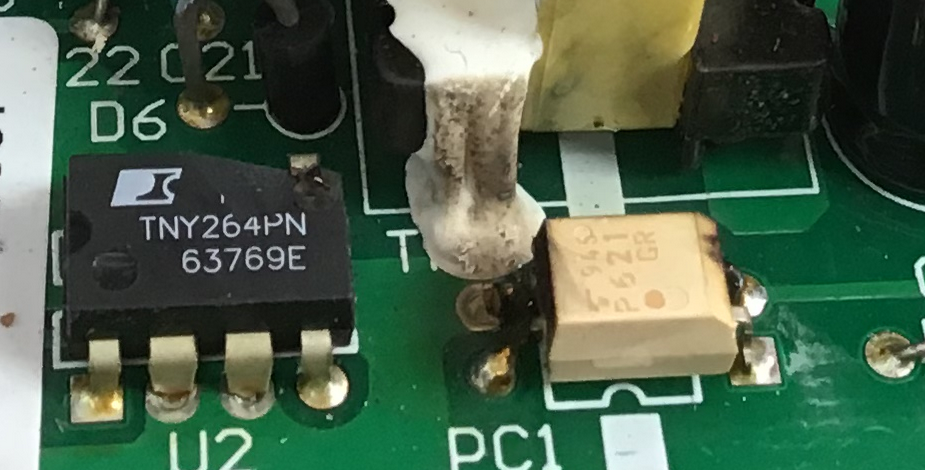

Photocoupler , Ic TNY264PN DIP 7 both have exploded Cause
Gregory
Smart battery charger
What can cause to blow the legs of the photocoupler P621
Close by is a Ic TNY264PN Dip7 that had also blown up.
Is there any thing that may have caused this
My guess is that the TNY died first and took the optocoupler with itself, but without any more information it is just a guess.

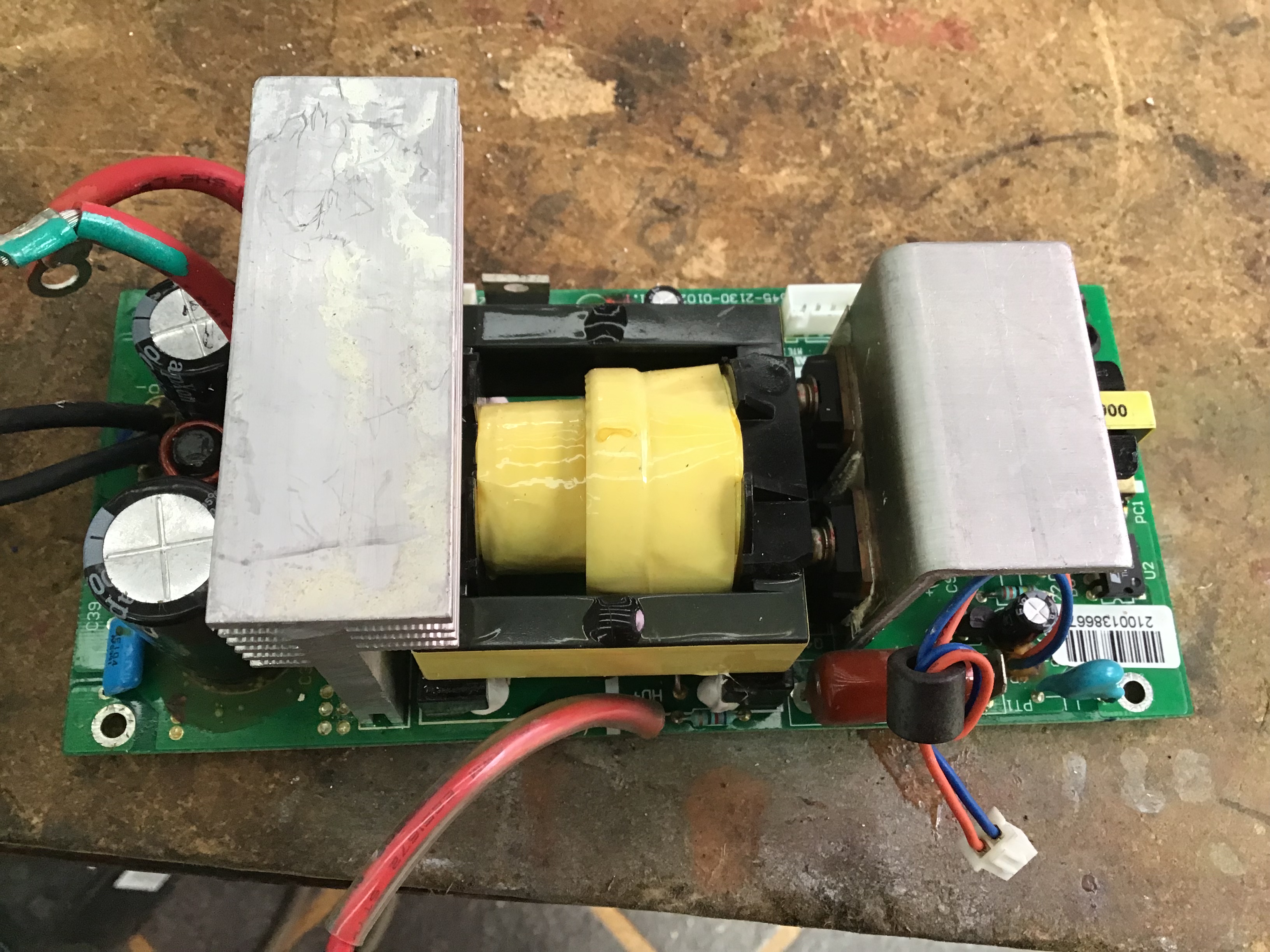

The charger is 12vv 30 Amp
3 Stage Switch Mode
Battery Charger
Number BC - 1230.
Can any one supply me with a circuit diagram

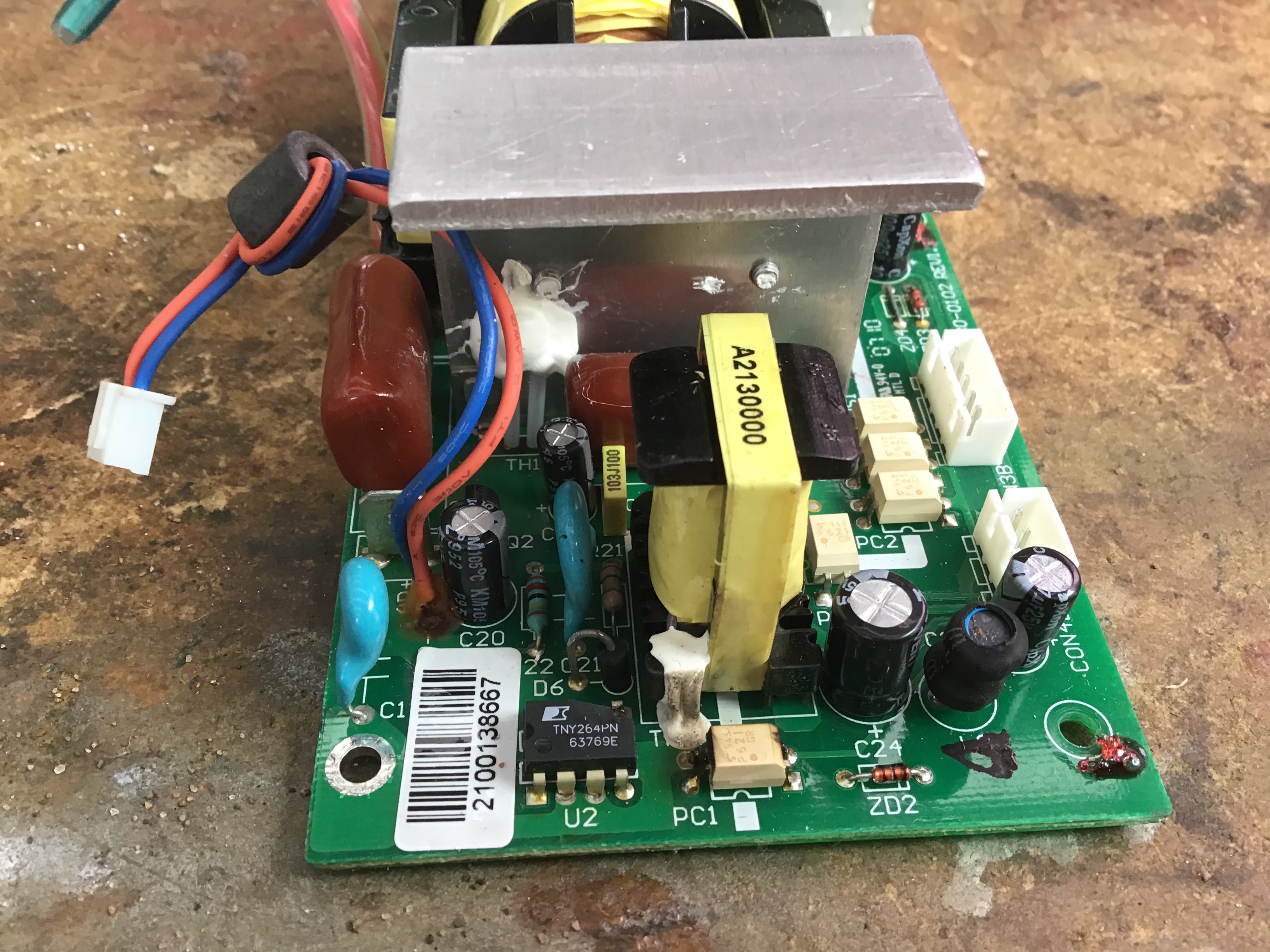

As you can see the IC 7 dip is damaged
And the photo coupler is also damaged
That’s may help you to help me. As I am not very good at fault finding except the components that are damaged.

It is typical for the TNY264 to blow up. I can see it was real hot.
I can not see if the photocoupler is dead. It should be hard to kill. The black smoke on the coupler may have come from the TNY264.

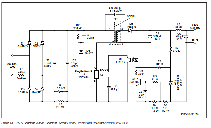

I do not have your schematic but here is one that is close.
D5 on my schematic might be shorted. Very typical. That will heat U1 and maybe kill it.
Also D6, C3&R2 might be bad and that will U1.
Based on the schematic, my guess that there may have been a voltage spike on the AC line, passed thru T1 to the Tinyswitch and blew that. In the process of blowing the Tinyswitch, voltage went from the D pin to the EN/UV pin which then blew the opto isolator.
This assumes the opto isolator pins blown are the detector. If the other LED side is blown, then the "safety" capacitor across the transformer possibly shorted, and blew things on the output side (and LED emitter of optic isolator).
Pin 5 of the Tiny is what seems to have popped, that is the "D" pin, suggesting that is where the high voltage or current occurred...
If the Drain of the device is shorted to the Source, that will be the reason for a fuse blowing.
Just my hunch, maybe someone with better experience with these types of supplies can suggest better options.

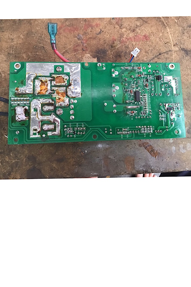

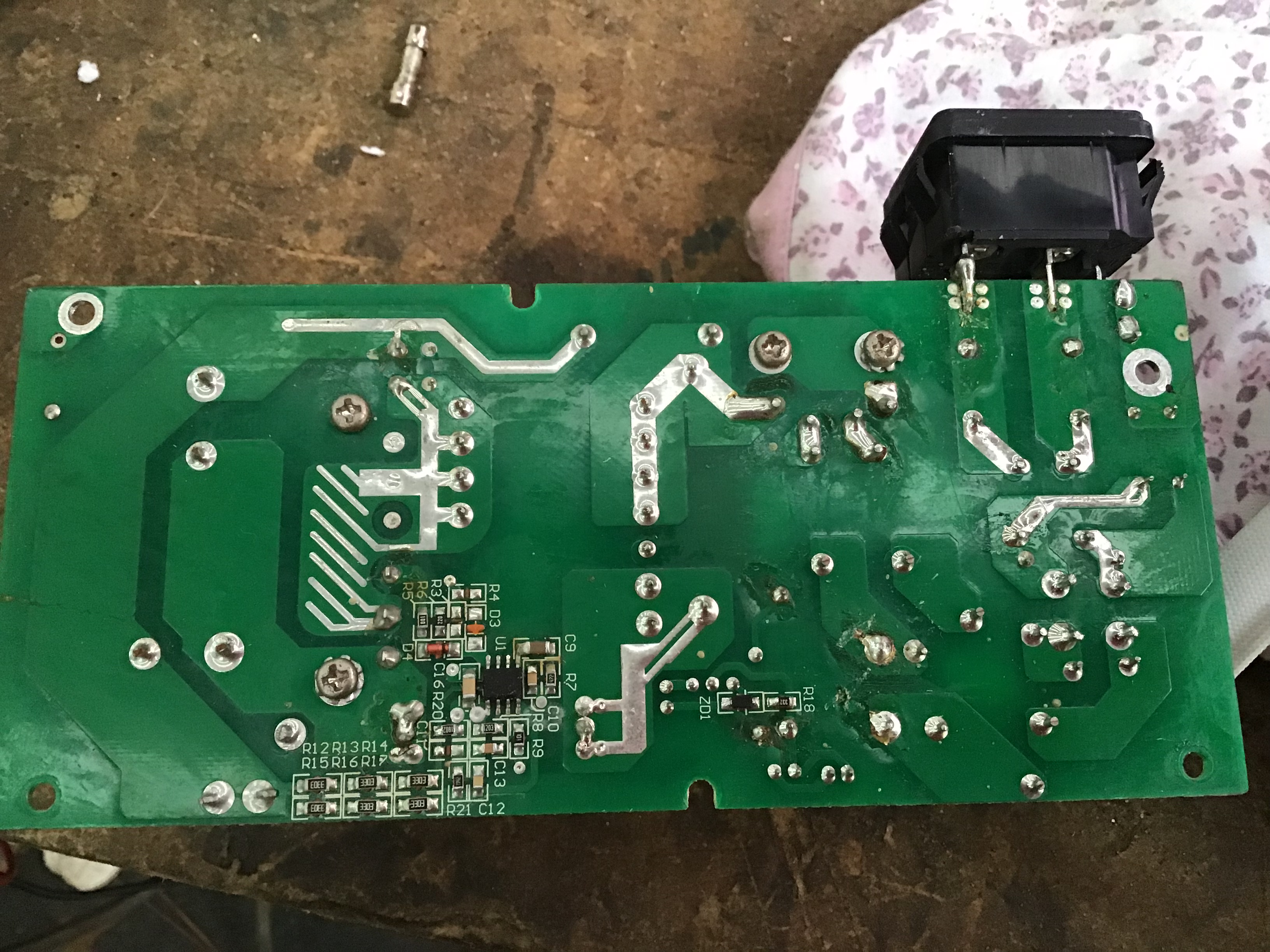

Gregory, Are you sure that the picture of the underside of a board is the same board as I can't match up the hole pattern of the 8 pin dip package ? I don't think a switch mode power supply is the place to start learning electronics. I suggest that you start with something much simpler. If you intend to continue I suggest that you start by tracing out the schematic of the device and posting it.

I agree with ron the opto might be ok, just blasted with magic smoke from the tny.

This is the board with the other side
