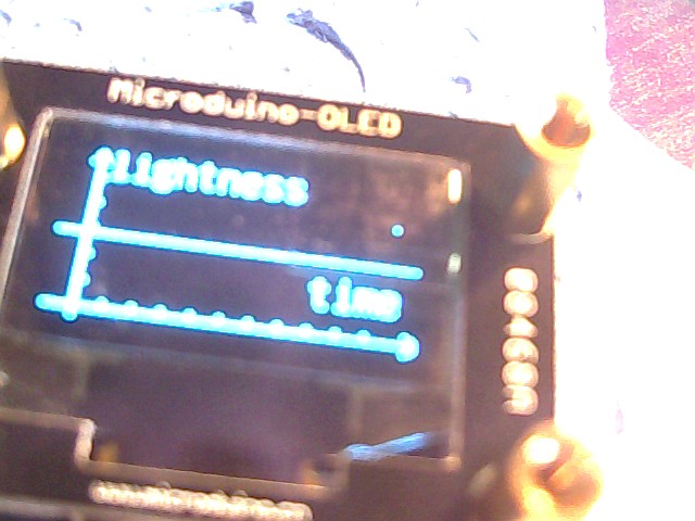

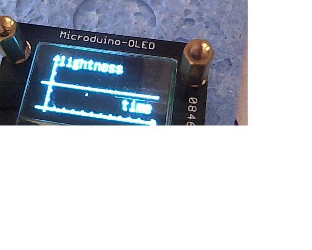

Photoresistor luminance measurement in the form of dot motion on OLED12864 screen display effect.
Experimental equipment
Mango controller (Arduino UNO compatible controller)
One expansion board
Several double-ended bus bars
Photoresistor module
Miscrodino OLED (12864 display with I2C interface)/or other LCD
Connections
Arduino GND to OLED GND
Arduino 3.3V to OLED VCC
Arduino A4 to OLED SDA
Arduino A5 to OLED SCL
Arduino GND to GND of photoresistor module
Arduino VCC to VCC of photoresistor module
Arduino A0 connects to the check interface of the photoresistor OUT
Principle of photoresistor module
Coordinate system depiction
In the screen of (10, 60) as the origin, the horizontal line Y = 10
the firm flat line X=60
Use drawLine() to draw two lines
Draw the small arrow again
A horizontal line with (128, 60) points, firm line with (10,0) points to draw small arrows
Draw a straight line in the middle of the screen for easy viewing
Continue adding tick marks
Also need text description
Define the integer variable sensor value to read the value of the analog port A0 and map the value of sensor values to [64-0] (the height of the screen is 64) and pass it to the integer variable outValue.
After mapping, the output value is higher when the brightness is high and lower when the height is low, in order to be in line with human habits.
Print out the result on the serial port
To avoid refreshing too fast,
Each depiction is delayed by 0.1 seconds, and then another depiction is done.
The Arduino code is as follows.
The program running effect.
Test results during daytime
Place your hand on top of the photoresistor and block it with the shadow of your hand, and the bright spot bounces near the X-axis.
After turning on the lights
![195417tplg13gvpmuvuq4v.jpg](https://image.geek-workshop.com/forum/201308/05/195417tplg13gvpmuvuq4v.jpg)
![195422ei02fg51eubb1ja0.jpg](https://image.geek-workshop.com/forum/201308/05/195422ei02fg51eubb1ja0.jpg)
