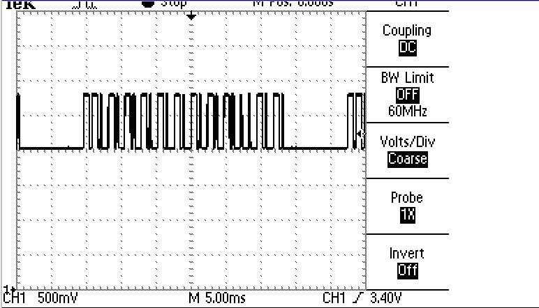

first of all, thanks for the reply Skyknight :D . The reading is using one pin (ra1) (I don't know about low or high level.....can you tell me what is it?......I am a beginer..... :eek: ). The signal is changing-with-time-digital-signal I guess.... and I have to read and store 25 bits digital signal. I have written a program that similar with your idea.....but still, it doesn't work..... :( . So, do you have any more idea about this?.....

I am getting the signal from a transmitter. The signal look alike your attachment Skyknight (using one bit). Unfortunately, my project has to use PIC16F84A. Thanks anyway.

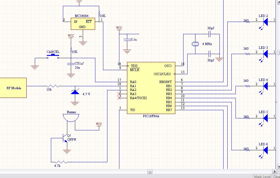

The freq is 433 kHz. Oh, maybe it'll be better if I attach my schematic diagram and one of my example input signal. As you can see the signal is received by the RF module first and then goes to ra1. Actually I have eight transmitters which transmit eight different signals. I have to identify which signal is coming, and then turn on one LED lamp (there are 8 LED's). one signal type for one LED. Thanks again......
