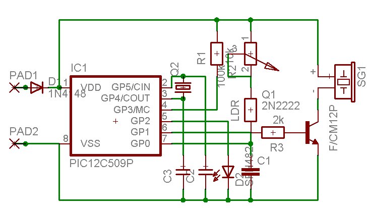

I need a circuit to detect if a light is on and beep every 30 seconds while the light it on. I have an LDR/cap on one pin of a 12F509 and a piezo on another pin. At 1Mhz with an Atmel 1200, it ran a week. I now have this on the 12F509 running at 32Khz. Basically, I ground the LDR/cap (LDR is pullup) count the highs, and pulse a piezo if the count is higher than a set number. I can include the schematic and code if it helps.

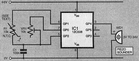

You might like to check the EPE website, they did a freezer alarm (using the capacitor charging technique) with a 12C508 a couple of years ago, it would obviously be VERY trivial to make it light sensitive instead.
One particularly clever point of the project was the fact that it used TWO charging circuits, one from a thermistor, and one from a fixed resistor - and compared them. This means that the battery voltage doesn't affect it's accuracy - I found that really impressive!, I built one, and actually modified the code (which the magazine printed later) to drive the piezo in bridge mode, making it MUCH louder with no hardware additions!.

I am having trouble now with the cap not staying low.. I really need an ICD2 it looks like. One thought I had, was used the LDR to interrupt the PIC and buzz and delay 30 seconds and end, and the main routine being a sleep. hehehe..
But I have this one built and want to get it running.
Here is the code.

Try posting the circuit you're using, so we can see what you're doing.

Thanks Nigel.. LED and diode are gone, using 4.5VDC of AA batteries. LED was to blink my LDR count. But it appears I
get 255 on the LDR at the 32Khz. New cap size tonight.

Well I'm glad the LED is gone, as you don't show a series resistor with it?.
You also don't show a supply decoupling capacitor either?.
As you want to maximise battery life, may I suggest that you remove your capacitor and turn your MCLR pin into an input. Connect your new input to the junction of your LDR and your preset.
You can now save lots of power by making GP0 high and stopping any current flowing through the LDR/resistor combo. You can momentarily make GP0 low and read GP3 (MCLR) to check for light/dark. You will probably have to change the value of your preset to get the right transition level.

I think I am with you. Make a voltage divider that I can power and then test the junction, then remove power from the LDR and sleep 30.. That is great.
So use MCLR at input to read the junction, ground preset resistor, and LDR to GP? to power the voltage divider? Might be fun to find the trip level, but I like removing power from the LDR for that 30 seconds for sure.
Nigel? LED was a thought that never made it. On the CAP you mean for decoupling?
OK, the EPE Freezer alarm was in the May 2002 issue, I've scanned the circuit and attached it!.
As you can see it's VERY simple, you could replace the thermistor with your LDR - it does two readings, one of the thermistor, then one of the variable resistor - it then simply compares the values. This compensates for any changes caused by battery or temperature fluctuations, as they would affect both readings (with the obvious exception of the thermistor itself). In between readings it goes to sleep, and is woken by the WDT.

WOW.. That is cool.. So they set high on one termistor, ground junction, and count. Then go high on POT, ground junction and count? Subtracting thermistor from POT and that is the value?
I am lost on it, I see the logic with the two to compensate the for battery getting lower, just not the sequence to do it.
Something to play with for sure. I guess the 12C508/9 would handle 6V also, the F is 5.5 volts, why I went with 4.5 and no diode.
