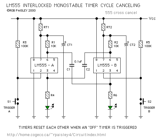

timing is easy. a cross triggered 555 or 556
when timer A starts then timer B starts, Timer B resets timer A
use relays, easier to use IMO
been here done that

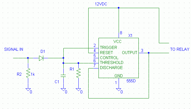

If I understand the question, the requirement is for a pulse extender that extends the pulse 90 seconds after the input falling edge.
I can't see why a 555 circuit (attached) should have any issues.

Ok so if i use two 555 timers i would then require two relays instead of one ? . That would take more space than i planed on but could be done but how would the S1 and S2 be triggered ? The switches would be replaced with transistors and a need to know how you would trigger them as it looks like they can not be left shorted and require a quick short and left open.
Any advice on that please. The signal will be 0v / 12v from compressor clutch and the fan control is to just short two wires that control a relay that is already part of the car.

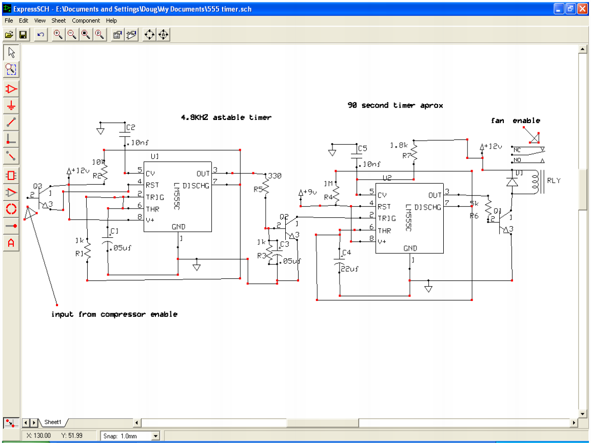

will have to draw a schematic.
okthanks for that and will order a 556 to start with. I would like a circuit if you have time and i can start to make the unit. I have a relay that has room for a small pcb inside it so will see how small i can make that once i get a working version. Only other question is how do i pulse the first switch . I would think with a capacitor and transistor . So the compresser voltage triggers the fist 555 and the second 555 drives the relay for 90 secons or if input is held shorted by input volts the second 555 will drive the relay but not timed ? The second 555 only starts timed output as soon as the short accross the first 555 S1 switch is removed ? Does the second switch S2 not get used then ?

this should get you started
you need to caculate the resistor and capacitor values for 90 seconds.
keep in mind that adding R7 will double the caculated time on.
the compressor enables the reset pin on the first 555 thus the astable outputs a 4.8khz frequency thus triggering the monostable timer.
the capacitorC3 /resistorR3 tied to the base of Q2 keeps the monostable timer triggered.
when the compressor turns off the C3 / R3 makes sure the 90 second timer is triggered.kinda like a missing pulse detector.
be sure to caculate the base resistor R6 (based on the resistance of the relay coil. easy way is a 10 - 1 ratio usually works.
coil = 500 ohm base resistor = 5K
R5 should be calculated as well. I just copied n pasted from another circuit.
you now have some home work to do but this should get you started.
Suggest breadboarding. I tried it out in Multisim and it works but ??
