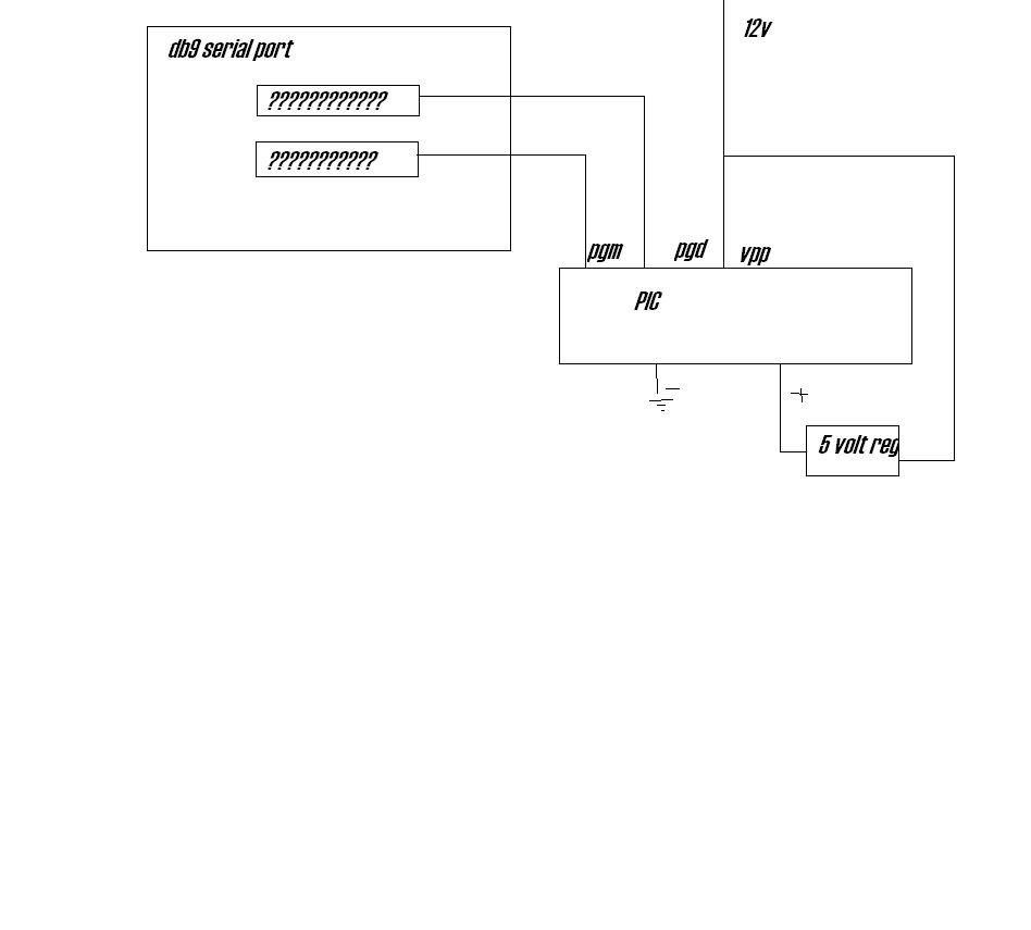

Is this the answer i've been looking for? So i just have to connect connect pgc and pgd on the pic and all the other ones?Will it work with ic-prog or winpic800?I mean that it is not in the availible hardwares, so i have to configure my db9 port?
DB9 is a socket, not a port, it's one of the two socket types used for serial ports though - are you talking about a serial port?. If so you've been talking about parallel ports with D0-D5 and ACK, not serial port connections.

Are you talking about a serial port?
db9 serial port yes.

OKAY... i am all mixed with the controversial facts that my father, you and internet provides me ( i dont say that you are wrong, i just dont know to look for what).
Maybe my paint schematic is very wrong, if it is, just tell me why.How can i configure ic-prog to work with this?
...This topic should'nt had got that big...
EDIT: i just seen that there is a pgm, what is it?
