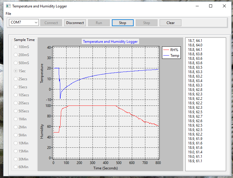

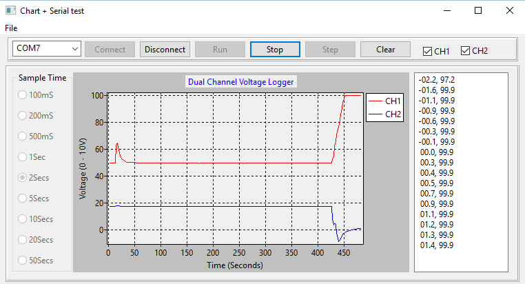

Here's a screen shot of it's first run:
The red trace is humidity (relative %), and the blue is temperature (degrees c) - the first 'blip' is me breathing directly on the sensor, and the second larger 'blip' is me squirting the sensor with a can of freezer. The sensor is taking a VERY long time to recover though, the temperature is back up to 14.8c now, but the humidity is still 99.9% :D

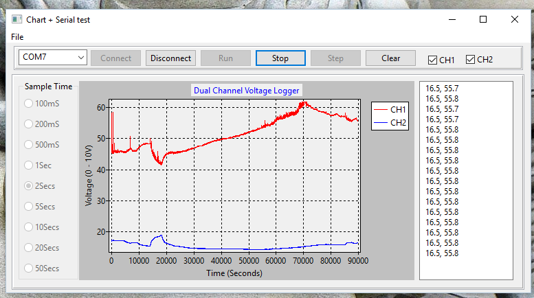

Been doing some more playing with Lazarus, added extra sample timings and split the graph into two section. This screen shot shows what happens when you squirt a DHT22 with a can of freezer :D
