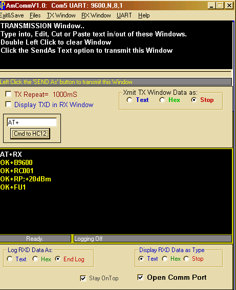

Image A05 is a test TX/RX between the HC12 and PC, using a VBasic GUI.
The intention is to get the Remote and Base units debugged using VBasic before conversion to Lazarus.

A little extra info on the HC12 transceivers that others may find useful.
Using a HC12 with the supplied spiral wire antenna,
RS232 settings: 9600 baud, N81
The HC12 has the recommended 1N4001 diode from the +5V supply to HC12, giving 4.3v at Vin.

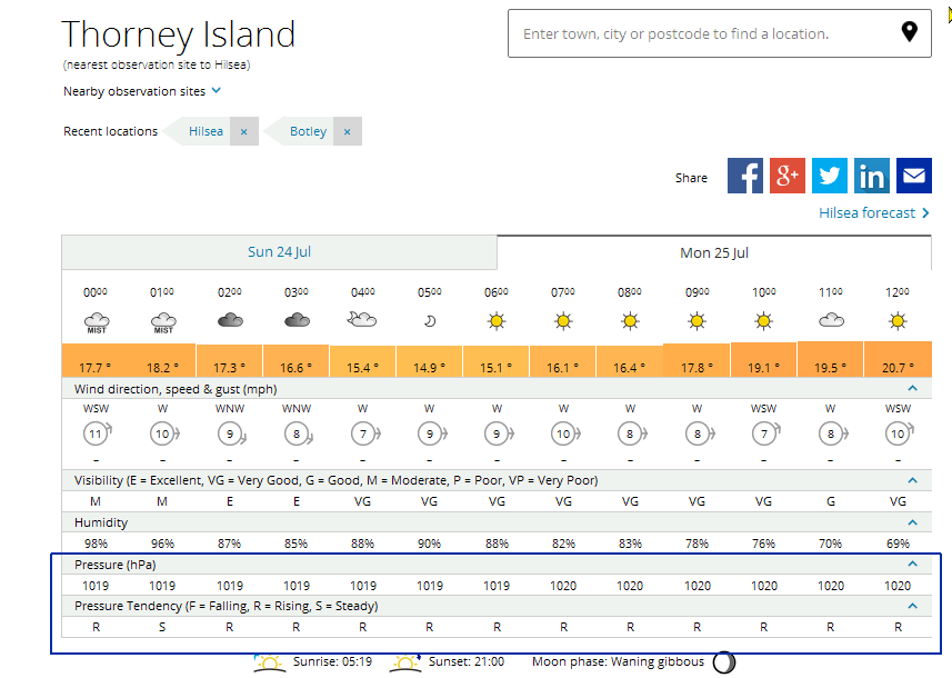

Transmitting temperature and humidity from a DHT22 sensor at one second rate.
Transmitter located indoors and the Receiver located in a garden shed.
So the TX signal has to pass thru 3 brick walls, 10 metres of free space and the shed.
Started with AT+Px = 8 , [20dBm], good strong signal at the RX
Stepping down the Px value in increments from 8 to 3
At Px=3 [5dBm] the RX, the signal would be sometimes be missed, depending upon movement of the RX PCB.

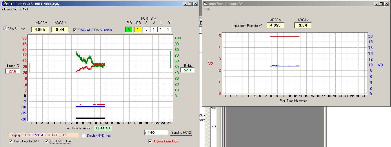

hi Nigel,
The HC12's are working fine, image posted showing the results using VB5.
The image shows the data from the Remote displayed on a PC,, Temp,RH%, 2 ADC,s a PIR bit and LDR bit, together with 4 PORT bits.
The data is time tagged and can be logged by the VB5 program.
As you may recall I had NRF radio's for this set up, but I could not get the required radio range.
The final stage is to modify my receiver for SD card onboard logging.
I am using 18F4520's as the SD card program needs at least 1K free RAM.
For info only, the HC12 will work OK with the 5 wires extended to 1.5mtrs, as do the USB/RS232 modules.
