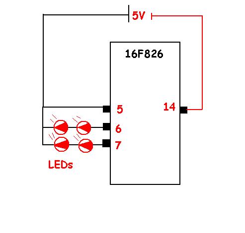

Hi All
Been trying to teach myself on how to program pics, I built mysef a serial "JDM" programmer and used PICPgm software to program the pic, code was compiled on Proton IDE Lite (PICBasic) as I found it easy.
I wrote a really basic program just to test, just making 2 LEDs flash.....but it doesn't seem to work, what I do know is, Proton only has the 16F628A listed on the program and I'm using a 16F826, not the "A".
When I program it with PICPgm, it does "verifies" and say completed and doesn't show any errors.
But when running it on my test board it doesn't work..... just have 2x 3mm LED in series from RB0 and RB1...
Quote

The test circuit attached. (sorry, I know its bad)
please help, where am I going wrong?:mad:

Nope, this will not do anything with the configuration fuses. You could still try to set them manually in your device programmer software. One thing for sure, the example I provided compiled fine here. Not sure if this could be yet another limitation of their Demo Version...
Finger cross, probably the .HEX file will never work for the non A 16F628 version anyways.
EDIT: wait a minute, is it really PIC16F826 or PIC16F628 you have in your hand?
configuration fuses ???? :confused:
PIC is the 16F628

Where did I go wrong?
one other thing regarding GCBasic....
When I 1st downloaded "GCbasic" I landed up with a program called "SciTE4gcBasic" with an application file called "gcBasicIDE", it opens up like a compliler....... but when I went to go find that compiler.bat file in the folder, there was nothing! so I downloaded GCBasic again from a different link, now i've got that .bat file but there is not application, only a couple DOS based files.... i'm so confused?
You are using one the IDE's great, forget about the cut and paste, just trying to get you going with least hassles possible.
Nothing wrong with the code that I can see, so have to look at the hardware. What programmer, and type are you using? Have you successfully programed code into a PIC before using that programmer? Can you see or read hex numbers in the programmer memory window?
Are you breadboarding the PIC, or is it on a development board. Is there a 0.1uf bypass capacitor across the Vdd and Vss of the PIC? Leds in backwards?
Sounds like either failed programming, the oscillator not firing up, or bad, wrong wiring connections.
P.S. not personally using any of the IDE's so cannot comment. Be sure that you have downloaded the latest update.zip from the GCBasic website, if you haven't done so already.
