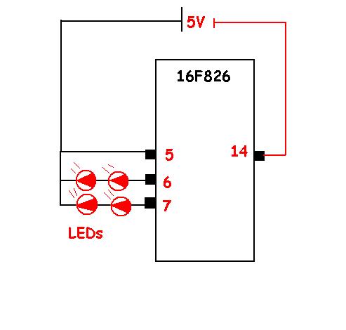

Have you successfully programed code into a PIC before using that programmer? no, just built it
Can you see or read hex numbers in the programmer memory window?
Not using the same PC as I do the programming on, but if i load the file using the same software on my laptop, it doesn't show anything, but is this not because the programmer is not connected? but once i've programmed the PIC, I use the "verify" button on the software, PICPgm, and it says its ok?
Are you breadboarding the PIC, or is it on a development board. Is there a 0.1uf bypass capacitor across the Vdd and Vss of the PIC? Leds in backwards?
Breadboard, as per schem
Sounds like either failed programming, the oscillator not firing up, or bad, wrong wiring connections.
the wiring is right I'm sure, see attached pic.

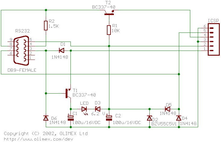

ughh, ......just search the posts in this forum about JDM programmers to read the tales of woe.
Download the aforementioned zip file and copy into the GCBasic dir anyway. It will have improvements, since the 9.30 version was created awhile ago.
Yep, leds in backwards per schematic. Realize if you swap them around they will be in a common anode configuration, and the PIC port pin will need to be low or off to light it.
The other way is to leave the leds as they are, but route your led common cathodes to ground instead of the 5V positive per schematic. Use 1 led and a 330 ohm resistor per pin to limit current. Have never killed an led by flip flopping around on 5v supply, so easy to double check polarity.
Install 0.1uf capacitor across Vdd and Vss as near to the PIC as possible!! If that's an unregulated battery supply, putting a 100uf filter cap across Vdd and Vss wouldn't hurt either.
ugghhh.... when output pin high, does it not "supply" the 5V?
The other way is to leave the leds as they are, but route your led common cathodes to ground instead of the 5V positive per schematic. This is how its done, must've drawn the schem wrong...:eek:
will remove the 2nd LED and add 330 ohm resister
