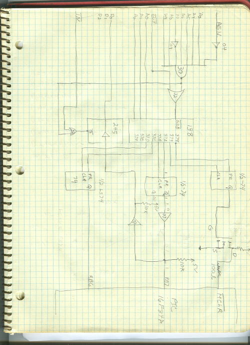

this is the circuit.

can anyone see a problem with my circuit.
specifically the connection to RB7..
cuz when i try to read back just one line of code, i get back whatever RB7 was left at.
i've fixed the problem of leaving RB7 low, cuz with open collector outputs on the 7407 an active output ( transistor On) would sink RB7 low when it is trying to output data....
so after the command to read the data from RB7 i set RB7 high so it can sink or not the output..
but it isnt working ???

It doesn't look like a workable PIC programmer, you only have a single data connection (which is read from RB7), where are the writes to data and clock?, not to mention Vdd and Vpp.
A simple write to port[$378] accomplishes bringing MCLR To 14 V.
And a write to port[$379] brings MCLR Low.
similarly a write to port[$37C] brings RB6 high.
and a write to port[$37D] brings RB6 low.
Vdd & Vss were omitted for clarity
RB7 IN was the only one i needed the data bus for.

Try replacing the 10K pull-ups to something faster like 1K-2K. You may be reading RB7 almost immediately after bringing the output of the 7407 buffer high.
In software, you may have to delay the reading of RB7 a few intructions after writing to port[37Bh].

Obviously doing the delay in a simple software loop is completely processor speed dependent - so it's not very good practice.
As you mentioned Pascal (and the code above is Pascal), I'm presuming you're writing for DOS? - in which case the Delay() procedure gives a processor independent delay time with millisecond resolution.
As WilliB mentioned, you are likely to have problems with the speed of the pull-ups, which is another major reason not to build a PIC programmer on an I/O card. I'm presuming (again!) that you don't take your PC to pieces to plug the PIC in?, instead you're attempting to do ICSP (In Circuit Serial Programming) with a long wire from the PC to your target board?. This will cause huge problems, the wires from the 7407 to the PIC need to be REALLY! short - under an inch is good, with a couple of inches likely to prevent it working properly. The basic reason for this is the inability of the pull-up resistors to pull the line high fast enough, due to the capacitance of the wires. For ICSP you really need a more active drive than a pull-up resistor, something which can provide some current to overcome the capacitance.

i just checked the rise time of MCLR.
it rises to almost 12v in 10 uS or so..
Not good.
the Maximum rise time is 8 uS.So say the specs.
also the almost 12v kinda bothers me , it might be that the scope needs calibrating.
* back to the drawing board* :oops:

i've calibrated it as best i could but still reading thirteen Or so volts when it should be 14 ??
I am going to shorten the connections between The FET and the MCLR input .
I'll let ya know what happens.
