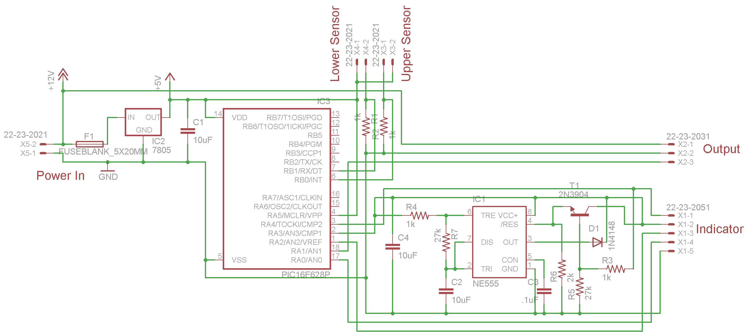

Ok, I've put a modest (10K) resistor in between the sensors and the input pins of the PIC, what code would I have to insert to debounce the switches from within the software? :confused: I've been making a lot of changes to the circuit, so the drawings I may have attached to this thread no longer apply. one of the main changes is to move the flasher from the indicator circuit to the main circuit leaving only the LEDs and their resistors. but I'm having trouble with the idea of the likelyhood of feedback of +5V back into the 555 via Pin 3, but I put a 1N4148 Diode to block it. Is that a good Idea? I've included the circuit as it stands now, even though I may end of changing it as I get ideas.

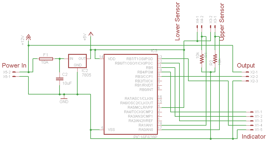

I'm still on working on trying to figure out what kind of switches to use as my upper and lower sensors. I read in different places that you can debounce switches from within the code. I did a search here and got a bunch of results that seems to point to the resistor/capacitor combo or an in-line resistor and also debouncing within code. I'm attaching images of the board and schematic to show the changes I've made to my design and layout.

Do the debouncing in code, it's mostly a simple delay.
That's what I was thinking of. Where would I put the call to the delay subroutine in the code when I want to debounce the inputs? Would it be just after the inputs are scanned or further down after the action code? I'm thinking just after the inputs are scanned.
Rather than insert a delay, you "poll" the inputs and use a register as a "flag file" to detect the condition of the switch(es). This allows you to use a display at a later date and not create any flashing on the display.
What do I need to do to poll the inputs? I've looked at a several sites that didn't even cover that in their tutorials. Give me a brief sample and I'll go from there trying to fix my code.
