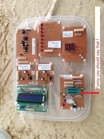

Was toying with the idea of a Zero Inserion Force (ZIF) socket. But think bringing the appropriate pins out to a header would be the best, unless convinced otherwise.
Funny you should say that .. ... All three Main Boards have ZIF sockets and I have a small set of IC's soldered into turned pin sockets.

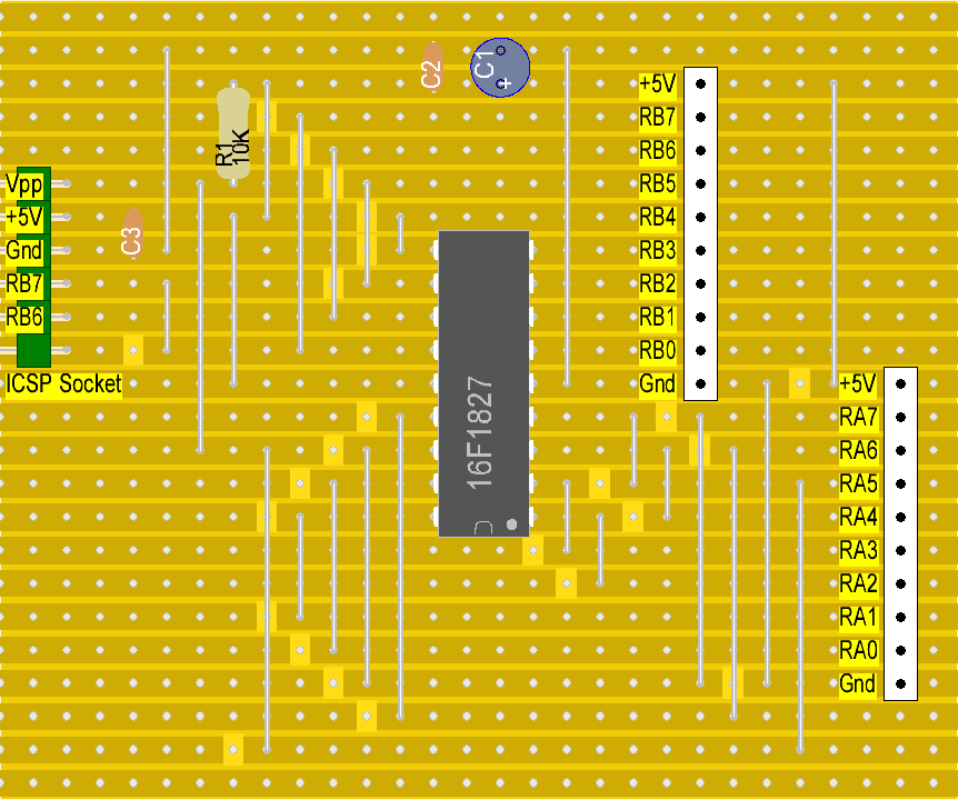

Veroboard is not that common on this side of the pond. It can be purchased but not a lot of choices. Last time looked into it there was 2 or 3 distributors. 2 in USA and 1 in Canada. With that in mind was thinking of etching the boards.

If you want an ISCP version, here's one I use with the 16F1827 (or any 18 pin device), powered from the PICKit3 as well, so no regulator on board.
Hi NG
Thanks for that, looks useful .. .. ..actually though I'm quite happy with what I've got .. .. I put some ZIF sockets on the 3 Mainboards and soldered a set of ICs into turned pin sockets .. .. safe as houses ! I responded to questions from other members and lacking the personal knowledge, relied on a quote from your tutorial document.

I used ZIF sockets on early boards now I use normal socket an add a 6 terminal ICP telephone socket with these jumpers on the two PGM lines if needed.
Max.
Hi Max
Good idea.
Any chance you could show a sample for the members?
I have used the strap as Max posted, however keep in mind the normal 3 PIC pins ( data, clock, reset ) need possibly two positions, so 3 pin headers each. Vdd and Vss can be hard wired to ICSP pins .
