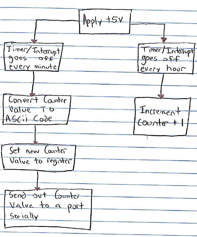

Recently I've decided to learn how to program micros in C. I"m a hardware guy trying to broaden my knowledge so when it comes to programming I"m quite a noob. That said:
My project is simple. I'd like to design a keyboard hour meter which will basically log the amount of time the keyboard has been powered up throughout it's life. The highest it can go is up to 9999 hours. My chip needs to be able to figure out how long it has been powered up and then spit that out on a port serially every minute.(It will be hours but in ascii code) I will then hook that up to my serial port on my computer and see the amount of hours on a hyperterminal connection every minute.
I have attached a block diagram of where I am in the design so far. Logically I think it should work but wanted to see what people on here think about my path so far. What I"m missing or overlooking. I know nothing about timers/interrups but I do know that they are going to be needed in this application. Basically can someone give me some direction but not just the answer. That won't help me any as I"d like to do a lot of this myself. It's the only way I learn.
Responses much appreciated!!

Base your interrupt on a timer roll-over. Increment a variable in the ISR when the interrupt occurs, to count the roll overs until you mark one second, then set a flag which you read in the main loop. Look up Real Time Clock for examples. What is important is that you do not try to do 'too much' in your service routine. You want to do all the heavy lifting in your main routine.

Which compiler are you using? That will dictate how to write your handler. In SourceBoost, I do it like this:

If I remember, in HiTech it is something like this:
void interrupt tmr0_int(void) {

Thanks Beebop. Unfortunately I can't afford a real compiler so I"m using High Tech C lite. Though, for my application it suits my needs just fine. Plus it's free :)
I'm going to take a look at this now. Thanks again. I found reading the high tech C manual to be very helpfull. So if anyone is reading this and is at the same point I"m at I highly suggest going to section 5.21 in the manual and read "interrupt handling in C" haha RTFM!
