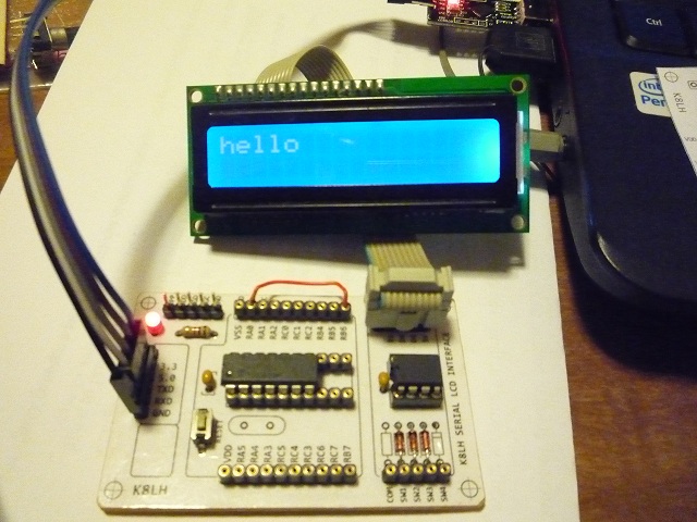

I also notice that you have a ICSP header . how do you isolate it from rest of the circuit ?
I isolate the ICSP pins by disconnecting anything that is plugged into the RA0 (PGD), RA1 (PGC), and RA3/MCLR (VPP) connectors before programming. I got half of the wiring done on the new board today and I successfully programmed a 12F635 and a 16F1623 using ICSP (yippee!)...

Progress on my new proto' board has been slow. I finished wiring it up a couple days ago but I only just got it up and running today. In the picture below, the larger device on the left is a 14 pin 16F1823 and the 8 pin device on the right is the K8LH 12F635 Serial LCD interface.

i got a new monitor and see the 2 broken once as an oportunity to get my limited skills to use :) I have been working on a pcb design and i just need to add a ICSP header only problem is that i need to do some more reading on the subject .. my idea is to separate the ICSP part from rest of the circuit using 3 pin headers and jumpers .. got limited spcace but i'm sure it will fit on my pcb :)
