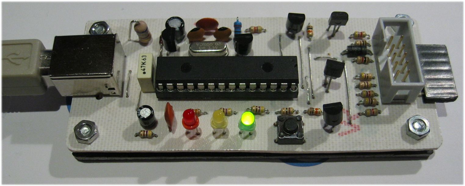

I've got a genuine Microchip PICKit2, a Junebug (Bill kindly sent me the PCB and I built it up) and one of these **broken link removed** which I modified slightly so it uses the same 10-way header as the Junebug.
Bare in mind that if you build a clone it will need the on board PIC 18F2550 programming with the bootloader (chicken and egg :)). If you buy a kit it should come with it preprogrammed.

which one did you build - pickit2-1 or pickit2-1-mod? I converted the pickit2-1-mod design to surface mount parts and am almost to the point where I'm ready to send the board off to be made. What's your experience been with that design? I'm trying to decide if I should proto it or go straight to a PCB.
Have you tried the microchip logic analyzer on it?
I did the 2-1-mod version.
I used a ZVP2106A P-MOSFET for Q3/Q5
R7/8/9 47R instead of 33R shown
R1/R5 10K instead of 12K
C7 470nF instead of 330nf
R4 100R instead of 75R
R10/11/12 470R instead of 680R
Not tried the UART or Logic analyser applications with it, but as a programmer it works okay
