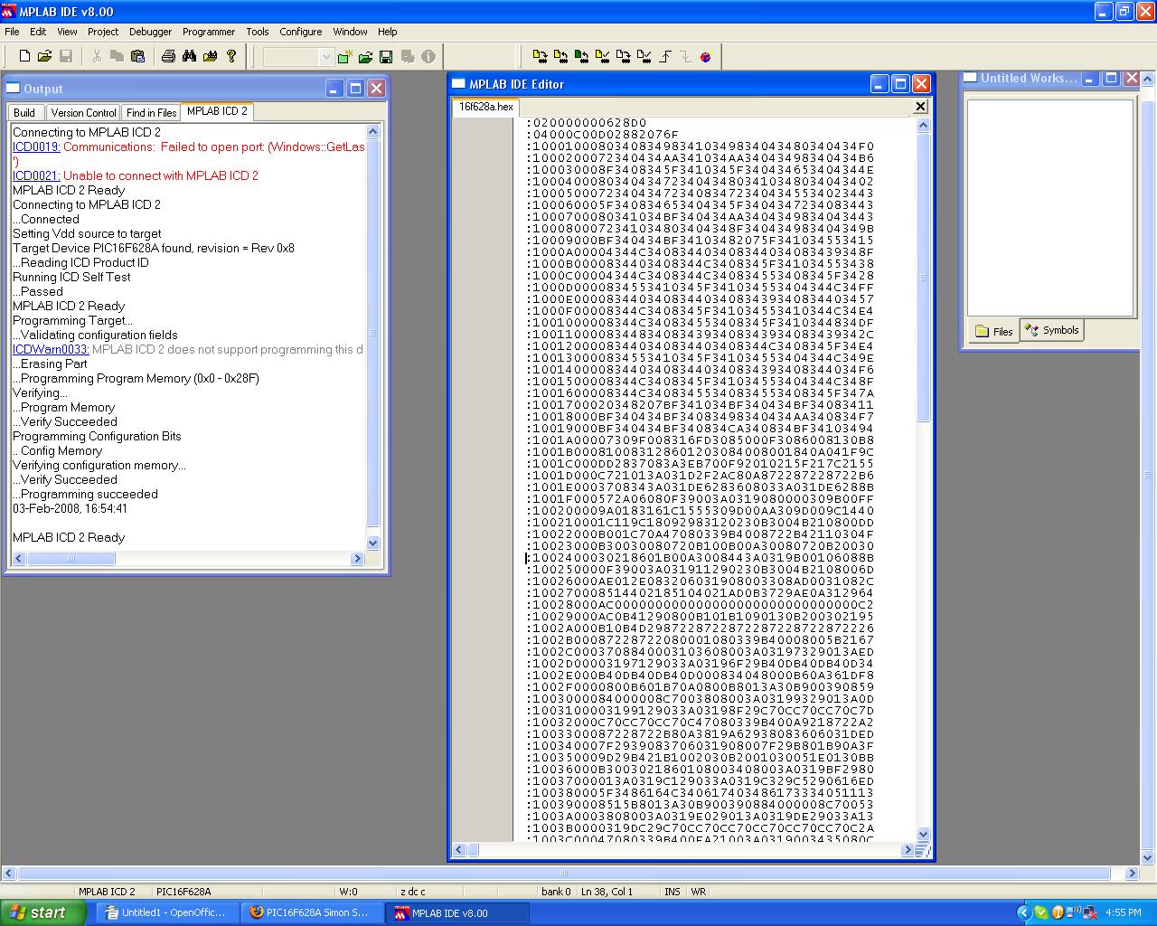

Yes I saw that but would I save it as a .hex file and import to chip?
This is what I got when I programmed it. I trust it will work?
MPLAB ICD 2 Ready
Programming Target...
...Validating configuration fields
ICDWarn0033: MPLAB ICD 2 does not support programming this device if both the internal oscillator and internal MCLR are selected.  You may continue programming, but you are encouraged to cancel, reconfigure your device, and try again.

You should heed that warning, you may not be able to reprogram the PIC if you don't.
As long as it's the exact same PIC and the same target schematic it should work fine.
PS I looked at the schematic, and there was no need to force MCLR_OFF as he's tied MCLR to VDD.
PPS a 4.5V (3xAA) supply would be much easier to build than his switching design.**broken link removed**

Actually I don't Know if I programmed it correctly. I copied the hex file and saved it as a hex file, but it still says it's a hex.txt file. Can you turn it into a hex so I don't kill the pic with random stuff?
Actually not, the diagram is marked with MCLR not connected if you use a 16F628, although you obviously could connect it and modify CONFIG accordingly.
ok, I put the hex into MPLAB and saved it as a hex file. I then programmed the chip and I am hoping it will work.
ok here is what my screen looks like. Does everything look correct? I saved it as a hex file and It should work. I imported the hex file and pressed program. This is where I am at right now. I AM NOT USING THE ASM SO DON'T BOTHER WITH THAT.
I thought the red wire on RA5/MCLR meant it was connected.
Well I don't read hex. You could override the config settings, just pull down the config tab and uncheck the override. What PIC are you using?
Red means its not required. It just ties it high, so I don't see the point?
Anyways, should it work?
