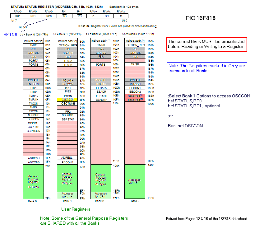

	[COLOR="Red"]banksel	PORTA
	banksel	TRISB[/COLOR]
	movlw	0		;set PORTB as all outputs
	movwf	TRISB
	banksel	PORTB
	movf	CCP1CON,W	;set CCP1 as PWM
	andlw	0xF0
	iorlw	0x0C
	movwf	CCP1CON
Again why Banksel PortA do u think its not needed?

hi Hesham,
Do you have a copy of the 16F818 datasheet.?
Study the attached image.
Its important that you understand the Bank selection.
I would suggest 'learners' of assembly language, use the STATUS register bits RP1 amd RP0 for Bank selection.
Once they understand the Bank selection process then start using the Banksel directive.

Can someone explain these lines? Why .126 not .128??
The 126 [7Eh], as explained in the program comments, at 127 [ 7Fh] 0111,1111 the motor is running forward, permanently ON.
For the value 7Fh is 0111,1111.
the next increment would be 128 [80h] 1000,0000, which in the comments is explained as a motor reversal.[ at the slowest speed].
255 [FFh] 1111,111 is top speed in reverse.
OK.?
