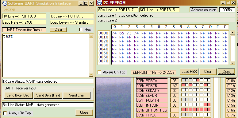

pic16f84 with 24c256 on i2c - simulation ok, real not working. oshonsoft pic ide
hitch
hi.

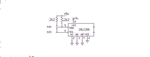

I am using the very old 16f84, supported by the old picstart i was donated. i am using a 4mhz crystal with 22pf caps. 5volts supplied via the 7805L.
i am trying to read write to the 24c256 to store bigger "files". I have followed both examples in the tutorial section but i get "nothing". I have no way of reading/writing to the 24c other than with the pic so i cannot verify either process. I have a serout routine to which works as it sends me text strings but not the data "read" back from the 24c.
pls help.
maybe clarify the read write statements. on how to read write multiple bytes?
thanks

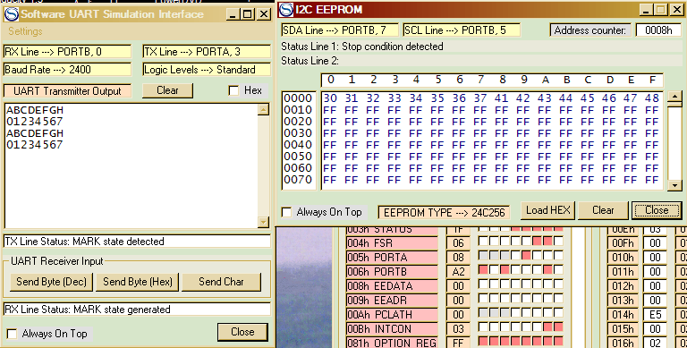

The waits are too short, I will rewrite your program using the Basic I2C external EEprom commands. it will be easier for you to modify it.
I have modified the program, it works OK in sim.
I will try it in a PIC tomorrow and post the results.
Try this version.

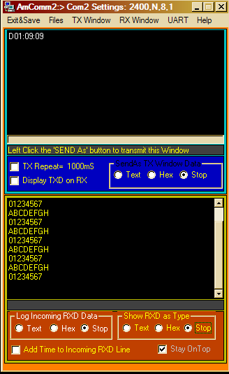

The modified Basic program I posted yesterday works OK in a PIC, see image of PIC output on my PC.
Do you have the 2k2 pull up resistors on the sda and scl pins.??
Also the TXD line inverter.??
Hi thanks for the replies -
1. i am using a max232 on the tx and have "reliable" comms from the pic.
2. i am using a 10k on the sda / scl as it is in the spec sheet.
i am going to try your code now ! it is a beautiful sunny day here in SA and i know its gonna work!

Its running here fine as I type, I use 2k2 pu's
EDIT:
I assume you have the 25LC256 address pins all to 0V, for address 0.??

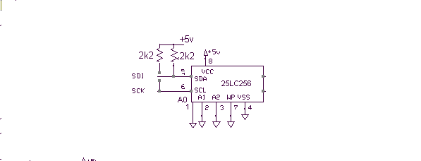

The pinout is like this image, the Basic should address the 24C256 OK, the A0,1,2 is in case you have more than one EEProm on the sda/scl lines.

In the basic command this is the EEProm IC address
I2CRead sda, scl, 0xa0, addr, data(addr)
so if A0,1,2 are grounded thats IC address 0xa0 for a second EEprom with A0 high it would be 0xa2
Where did you read about PB.6/7 pins.???

I think you are confusing the hardware address wiring with the Basic commands.
For only one EEprom connect A0,1,2 to 0V and use I2CRead sda, scl, 0xa0, addr, data(addr)

Your links to 0V of A0,1,2 are correct for EEprom address '000'.
The EEprom I2C string "I2CWrite sda, scl, 0xa0, addr, data"
0xa0 is the address, in bit format it is: '1010,d3,d2,d1,R/W
So the 0xa is followed by 3 address bits,d3,d2,d1 [able to address up to 8 EEproms] and the least significant bit is the Read/Write bit.,,, Read is '1' and Write is '0'.
I have checked the datasheets for the B.6 & B.7 and I cannot see any reference to not using them for I2C, perhaps other members may know.???
Are you saying the Basic test program I posted is working in a PIC.??? its still connected up here and it works every time.
BTW: Dont use the word 'data' as a standard variable in your programs, MPLAB and OS get confused.
Use 'dta' or 'dat'

For reference only this is a clip from the OS manual.
For example, for EEPROMs from 24C family (with device address inputs connected to ground) the value 0xA0 should be used for slave address parameter.
Both statements will take control over bit 0 of slave address during communication.
This means use 0xa0 for write and read in a OS basic program. the Basic will set the R/W bit correctly.

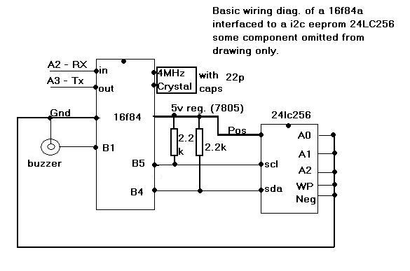

This image defines the normal addressing.

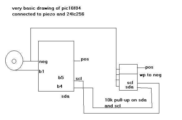

Hi eric
I have rebuild the circuit - using a fresh pic and eeprom
the pull-ups are 2k2
problem on the comms was a broken wire on the pc side of the db9. ;-) I checked that when the simple serout did not work.
also i changed the sda pin to Portb.4- that is the only thing i changed in your code.
I made the change because i use pin7 as the logic high for the switches on porta 0,1, 4
Rx = porta.2 and Tx = porta.3
However i am only running the code as you gave me - which should be fine.
alas still no output - now i can see the linefeeds but nothing comes up. in hyperterminal i can see the cursor move down but i get no other chars.
i would love to use another pic like the 628 or 88 but i cannot prg them on my picstart. and the 17c44 that i need to upgrade will only arrive in about 2weeks.
but i am not one to give up so easily just because i am hitting a brickwall. there must be an explanation why it is not working. here is a diagram of my connection again - i am using a 4mhz crystal with 22p caps. I do have (newly bought) 3pin resonators, would that make a diff?
just a note on the output of the prog. you gave me, when i set the baud to 1200 the output pattern looks correct, so i can safely say that the serout is working. I know the baud is 2400 but on 2400 i can only "see" the CRLF's. I have again double checked the wiring of my circuit. and i am going to "half" your program and burn the WRITE on one chip and the READ on another. Then swap between the two and see what that does. I am trying everything to find this problem. It would have been cool if i could read the eeprom without the pic, then we would know if the eeprom is atleast being written to which would narrow down the problem.
