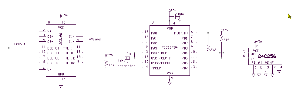

pic16f84 with 24c256 on i2c - simulation ok, real not working. oshonsoft pic ide
are you refering to pin4 of the pic? No i don;t it is connected directly to +ve via a jumber wire. I am using a 7805 and it has a 100n across pin 4(mclr) and 5(neg) then a wire jumer goes to +ve pin.
the eeprom is connected via 5cm piece of 4core wire - positive connected to the track close to ppin 15(+) , SDA (pin 5 on eep.) connected to pin 10 of pic (rb4) , SCL connected to rb5, Gnd to Gnd.

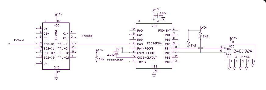

A quick sketch of what I have, it shows 24C1024, but it also works with a 24C256.
EDIT:
Added the 25C256 for clarity.

thanks for the schematic, but other than the resonator and the 10k pullup on mclr - our circuits look identical!
I will make the changes and try again.

IT IS WORKING. The new circuit has a 10k pullup on pin 4 and i am using a 3pin resonator (4mhz) instead of the crystal and caps.
The eeprom which i had built on a piece of vero is still configured as is with the 2k2 pullups on sda and scl.
here is the thing, as i am writing this everything is working - 01234567 with ABCDEFGH and it is looping and beeping. When i tried it 5min after finishing the new board it did NOT work. then i daizy chained the comms from board 2 back to board 1. removed chip 2 and placed it in 1. ran the code and it was giving me the blank lines again. then i again powered down placed chip back into brd2 and then it just "sprang into life". I am afraid to disconnect board 1, hahahah. and i did not put in the 0.1uf decoupling caps yet.
