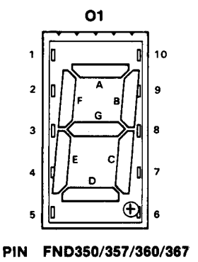

I changed the lookup table e.g.
yours: ;RETLW b'10001000' ;0
;RETLW b'10111011' ;1
mine: retlw b'00111111' ; 0
retlw b'00000110' ; 1
hi sniper,
LED Segment pattern is: x,g,f,e,d,c,b,a, so b'00000110 lights the c & b segments which is seen as a '1'.
E

This is still giving me a hard time
So I load the code to the chip and all i get is 00 on 7-seg screen its not running. but when i check it with the watch in mplab it shows that it runs fine the numbers come up in the watch so can anyone see what the problem is. I have added all the parts into the code from this forum depending on the display you are using.
;7 segment LED display - count up from zero

Hi Sniper,
The code you posted in your very first post works ok for me. The only thing that has been changed is the lookup table. It works with a circuit as shown in the schematic posted earlier...
Try this original code again (assuming you are using common cathode displays).

;THIS CODE WORKS OK! :-)
;THIS LOOKUP TABLE IS ALL THAT HAS BEEN CHANGED!

Are you using a Pickit to program your chip? Are you removing the pickit from the circuit after programming? You will not be able to run your hardware properly in debug mode i.e. using the pickit as a debug tool.
Edit: Just to clarify. Because the in-circuit-debugging pins (39 & 40) are connected to the led segments and the base of one of the transistors.
Also, although not related to the problems you are having, it's not necessary to set up the CMCON register. The comparators are turned off by default upon a reset.
