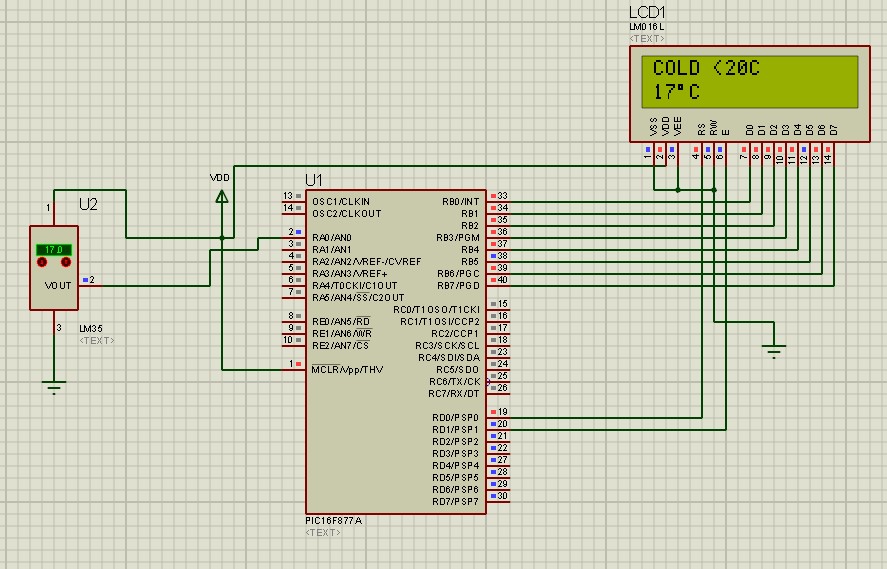

pic16f877A and LM35
i know it's work but iwant to let the value of tepretuer appear on LCD. i cant understand what you say abve, can you put your modify on the code here
I only just works.. Lots wrong..
I did this

Notice I used ANSEL to get the precision.. When you use the ANSEH two vital bit were missing..
The output from the sensor will need mapping... I get slightly over double the bits.. ie.. 20 degrees is 41 bits... 30 degrees was 62 bits... Linear but not quite half..
The ADC on your chip will differ, hence a map...
You will need a divide routine.... The input from LM35 is linear (straight line ) but doubles each bit...
You'll see in the code.. The RLF TEMP divides by two... Close but no cigar...
The process to change the input to an acceptable output is call mapping..
how i can do this
is this possible
Of course you can.... Go to piclist and grab 8x8 multiply and 16x8 divide routines.. ( The small div by 10 is from elsewhere )
Then you can make the map..
I can't do it all.... You'll need to step up sometime.. Piclist Is the goto place for code... .
Here you can borrow ( indefinitely ) all the math routines you need..
Incidentally! I hope you know how the ancient Chinese divide and multiply... Because if you do not... Hop over to Wiki and take a look see... This is how micro's do it effectively.. https://en.wikipedia.org/wiki/Chinese_mathematics..
