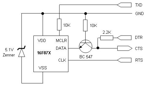

Hi Guys!
I need to program the PIC 16F876A through serial port. Here is my PIC16F876A programmer.
Please tell is this correct & what are the missing points.
Also do I need a resister in series with the RTS line?
That might work if your very lucky and you have a fairly old PC. There are much better alternatives. Have a read of this page. They suggest something like,
