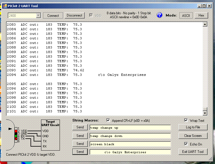

Since you are using Pickit2, you can use its version of terminal to see the output of your chip on screen, provided you have all set up right.
Go into tools on the Pic2 site and click on USART tool. Since you are using the 16F866, I assume you are using a breadboard or something. Figure out a way of connecting the USART TX and RX pins to the Clk and Data of ICSP. The diagram on the USART screen shows the connection. Make sure the baud rate on the USART tool screen is set, and connect. You should see something to go on. Going this route, you will eliminate the use of R232 and see what is happening. Build in steps.
Your screen might look something like my attachment:
i am actually using the PicKit2 Demo board from Microchip and i dont think i am allowed to eliminate the use of rs232, as we're supposed to use it to program the bluetooth module into the 16F886 later on.
Okay, I see. I did not realize there were stipulations. You still might be able to use the USART tool to help you get started. Luck.
