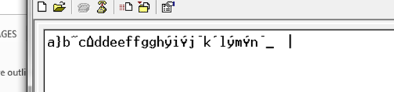

You can't say that "these characters work", but "these characters do not work". The communication either works or does not work.
When using Hyperterminal, only the characters e, t, d, f, w, m, o, u, g, v are being echoed correctly. The rest are echoing other symbols.
What kind of incorrect symbols? Can you give few samples (sent - received). Maybe there is a bit-pattern that reveals the problem.
Hi misterT.
attached is a screenshot showing the echoed characters/symbols. a,b,c... are the characters i types followed by the echo.
Also,
I took the f character (since it is being echoed well) and did the following modification to the code so that when f is received, the PIC will turn on two LEDs. But this is also not working. Why is that if the character f is echoed well?
This is just a guess.. The bit pattern of character f is '01100110'. If your baudrate is slightly off, that bit-pattern will transfer correctly, but maybe some other bit-patterns (01010101) do not transfer correctly.
The screenshot you posted does not help, because it only shows what is received. It does not show what is sent.
Yes!! But I think we can assume the baud rate is out anyway... but not by much!!

It would be helpful to check for bad characters and see if you receive them right. This will give you a clue on whether the problem is on the sending or receiving end.
when i had a problem like that its was start/stop bit related, either in my code or in terminal settings, or in the time delay(as Ian mentioned) , when i was debugging my own code, i found it helps to send characters 01010101, 11001100, and 11110000, then you can see where the binary is getting lost.
Its a framing error.... You have set SPBRGH to 129.... You need to set SPBRG to 129 and SPBRGH to 0....
Its working form me now
