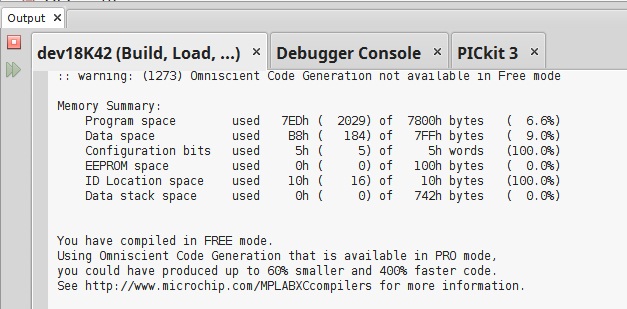

I noticed Microchip told me how bad my code was :eek: and suggest I send them some of my pension , to make it run better...
Shame they don't do a "hobbiest" or "Mature student" MPLABX, XC8 version .... :joyful:
I had to check a dictionary for Omniscient ....
Actually they told you how bad THEIR code was :D
If you actually google about it, in free mode their compilers deliberately add load's of totally spurious code in order to make the code run slowly, and take up much more space than actually required. A simple loop checking an I/O pin runs so slowly as to make it impossible to read IR remote signals as my assembler tutorials do. But even at that, my XC16 TFT graphics demo on a 24F runs considerably faster than the Arduino version (which is a much lower spec processor).
The MPLABX IDE also runs very slowly, it takes forever to compile XC16 programs, although XC8 ones are a little faster.
I was having speed problems with the Arduino IDE, which I cured by adding various directories to be skipped by my anti-virus, and that helped massively - it compiles quite quickly now.
