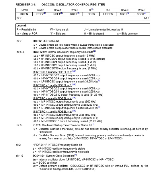

PIC18F45k80 UART Registers
OSCCON = 0b11100101 // OSCILLATOR CONTROL REGISTER
Am I configuring OSCCON register correctly ?
No need to wory about the last three bits, They are read only ( for stability ) I normally use two or three nop()'s after the command.
8Mhz will be..
OSCCON = 0x60; // b0110 0000.. Don't set bit 7.. That's for sleep mode..
