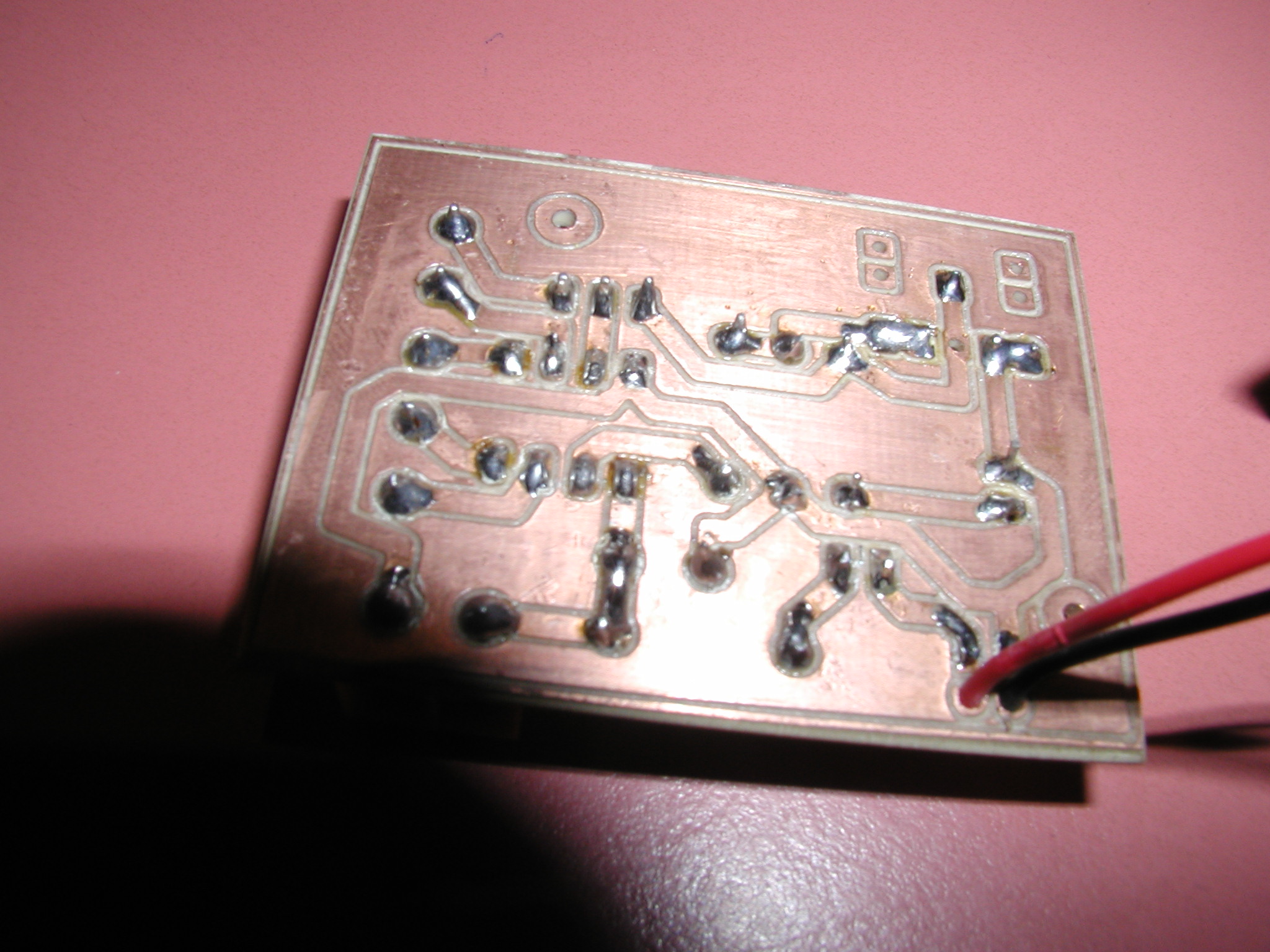

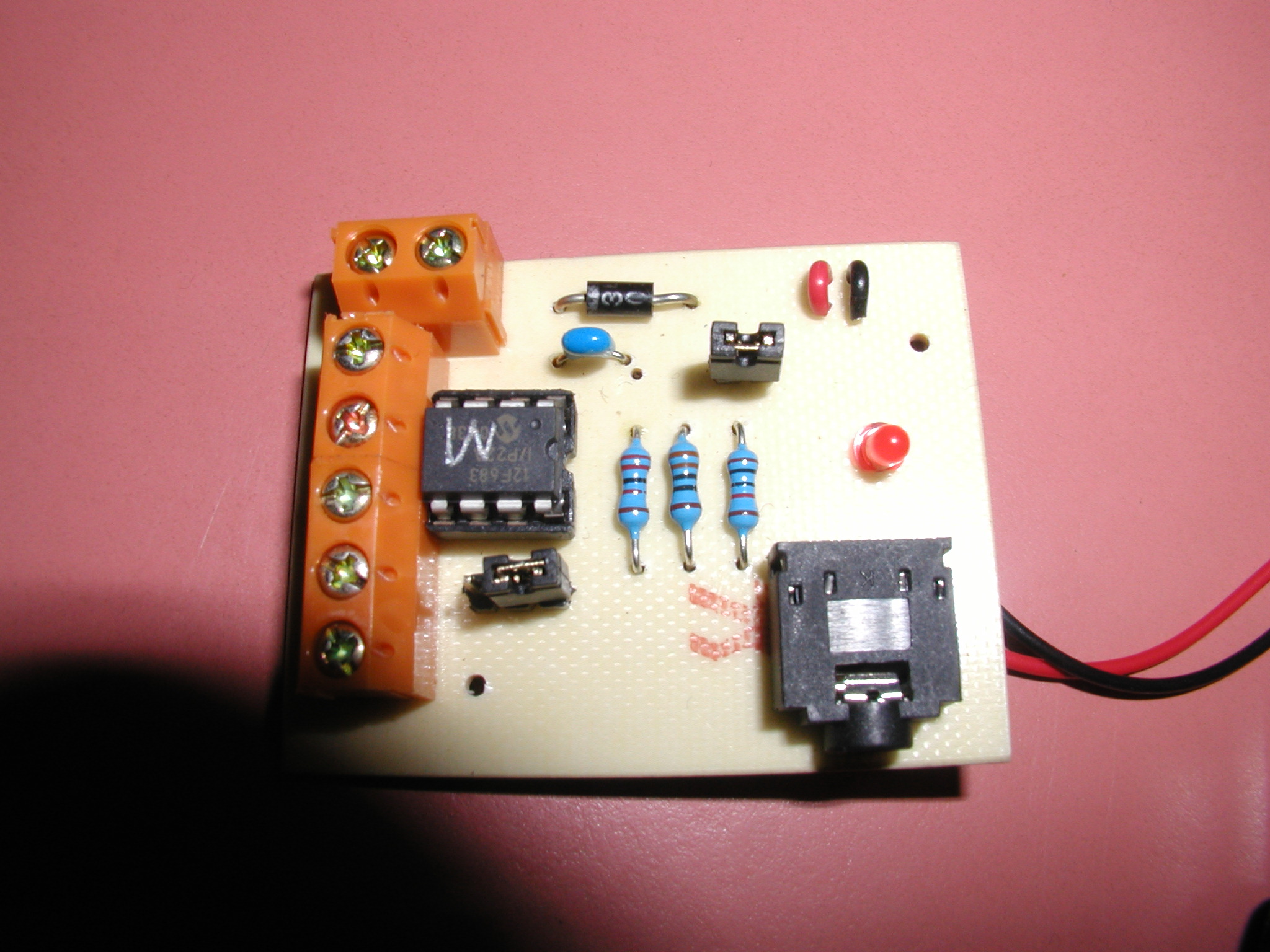

I made this PICAXE-08M a while back and there is something wrong with it...
could anyone please see to the attached images and help
thanks.

theres something wrong with the way the parts are soldered, like wrong legs or wrong resistor values

..no voltage runs through it even
OK I will make up the trio...
Then why not use your DMM and trace the supply around the circuit board to see where it stops?

umm..although i just got a pm about the resistors.
apparently they are the right resistors but round the wrong way or in the wrong order or something.....he didint specify.
is there a way u can see if they are wrong by looking at the pictures?
Better start hitting the books in your school, someones pulling your leg; resistors are not polarized. Current can flow through them in either direction.
PS those red & black wires have to be between 2.5v & 5v else poof goes the PIC (hope it's not a 9v clip at the end)
Ya know...a schematic is much more useful than photos of the circuit...easier to analyze.
What do you expect it to do anyways if you haven't programmed it for anything? Do you have a voltage regulator? How exactly are you trying to get 5V to the PIC?
What do you mean no voltage is running through it? The voltage measured across the +V and GND pin of the PIC is a floating voltage (constantly changing)? THat would mean there is a break between the traces going from the battery to the PIC. It's really hard to tell what you mean when you give so little detail and osbscure photos. No one is going to sit down and draw out the schematic themselves from your photos.
