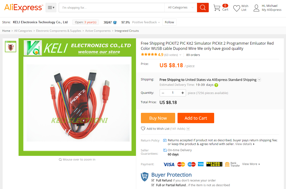

I recently purchased a couple **broken link removed** for backup. They work perfectly and are functionally and operationally equivalent to the real deal.

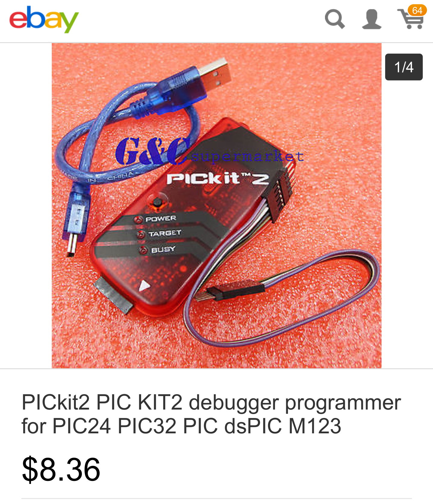

Well if Jon says it works just like a real pickit2 then perhaps I will look at purchasing same. Sure cheap enough.
They should be fine, MicroChip publish both the schematic and the firmware for the PK2, so it's trivial for a Chinese manufacturer to make an exact cheap copy.
It's even quite possible that they are identical?, and that the Chinese manufacturer of these are the people who actually make them for MicroChip.
I looked at the Aliexpress unit but no paypal?? so ordered two from G & C supermarket.
