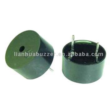

Hi I have a piezo transducer it needs some pulse to generate a sound.
My problem is what frequency & duty cycle I have to supply?
Data sheet is not available typically what frequency do I have to supply?
Is it a 3 wire one or a 2 wire?
Its two pin here is a picture

Assuming they don't have a built in driver. ie: they "click" when connected to DC:
Typically they operate around 3-5Khz. You could simply drive them with a signal generator and listen to see at what frequency it sounds the loudest. To be more accurate you'd need a sound level meter. It is perfectly OK to run them at other frequencies, but they just won't be as loud or efficient.

Totally understood.Thanks for the help.I'll give 3-5Khz & see with a 50% duty cycle.
The plastic housing is a resonant cavity that will make it loud at a single frequency.
Hi audioguru thanks for the info is it ok if I drive the above piezo with 100Hz?
It's hard to tell from the photos but I'm thinking that those things are about 1.5 cm diameter and the centre hole is about 2 mm diameter. That makes me think that 100Hz would be really low for it. I'd think higher, like in the 1kHz or more range. Not sure exactly but if you have a datasheet or if you can report its actual model number or any more information about it, it will be easier to work out.
I looked on the lianhuabuzzer site and did not see any photos which matched what you showed in your earlier post.
Another way to check would be to make a simple 555 or PIC square wave frequency sweep generator and check where it sounds loudest. That won't be exact but it would give you a general idea of what might work.

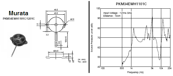

Here is the frequency response of a similar piezo transducer. There is no output below 1kHz, a huge peak at 5kHz, a huge notch at 8kHz and generally horrible flatness to the response.
I call it a whistle.

Some piezo transducers have a sharp resonant peak at about 30kHz which makes them very useful ultrasonic transducers.
