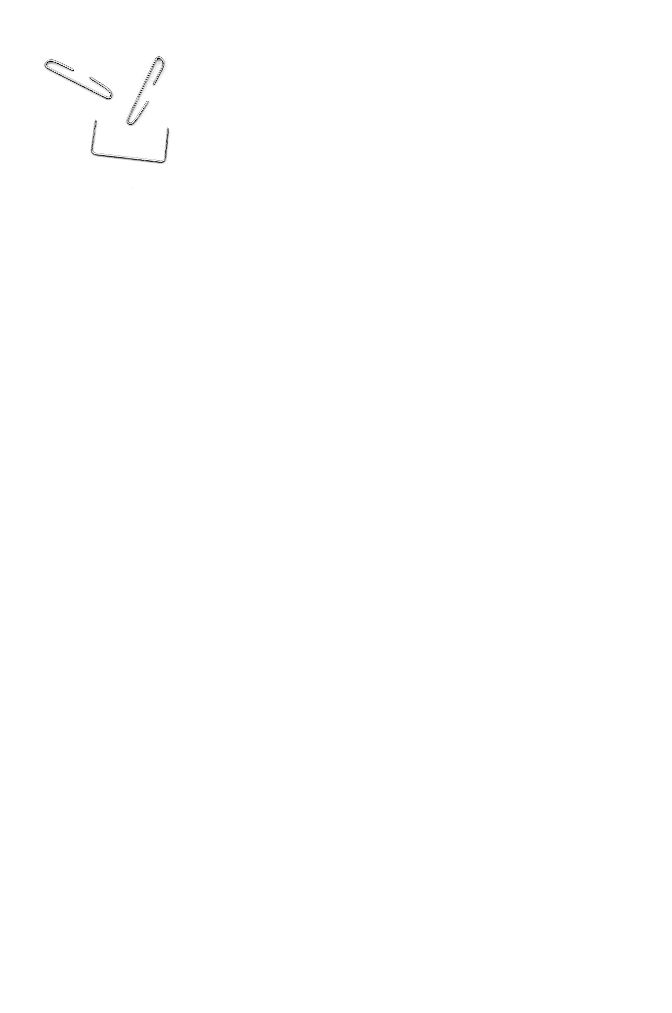

I have some pressure sensors that make a contact thru kapton to resistive element. They used something like a large staple with the conductive epoxy.
This will probably be the best bet for the material I am working with, but I might need to find a tiny stapler.
I think the staple is more for strain relief than anything else. Mine is really quite small, but thicker than a regular staple.
What's a regular staple?
Most staples look like this.
