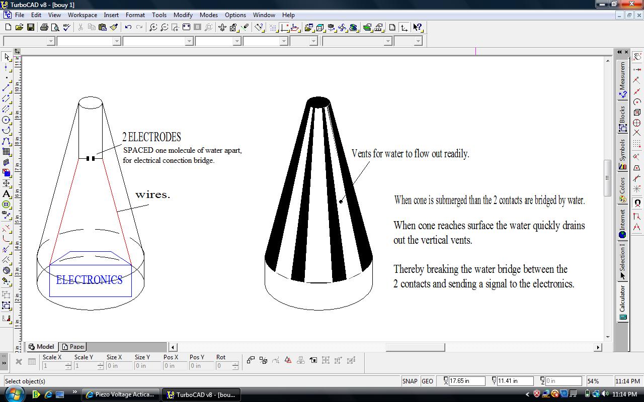

Here is one proposal,,,
The accelerometer/mercury switch has already been done and works in some situations, but in the heavy current area that this will be in it will not work. I like that you have come up with this and I am impressed because it shows that you are keen to the situation.
The other proposal has also been done. This is good! All have been done before and I am really impressed with your solutions.

Hi. Allow me to toss more methods to the table, as I believe it is not matter of making a switch work, it is matter of designing a fail-proof method.
That beacon apparatus will rise as a bullet towards the surface.
Flowing all around it, a lot of fast conductive seawater.
--- Magnets interact with moving conductive fluid, being capable of generating an electric signal (magnetohydrodynamics). That signal can trigger an electrical action so when such signal stops at surfacing, it can activate the beacon.
I do not see moving parts. I see no mechanical pressure sensors. I see no trickle battery consumption. I see no ports that can leak inside. But needs someone knowledgeable in this subject. Am not.
---Method two on the table: The device is anchored upside down at the sea floor.
(OR rises inverted)
Then the release happens, its buoyancy turns it 'upright' and an internal mercury switch starts some timing to activate in a few minutes, by then it has surfaced.
---Method three: The same triggering-to-release-anchor receiver can awaken it.
If the receiver/release mechanism stays with the anchor, it is lost equipment forever. Move the release receiver to the device and will also awaken it when released from the anchor.
---Method four: the device can have a reed switch internally, held open by a tethered magnet to the anchor. When shoots up, the magnet detaches and the device is awakened.
