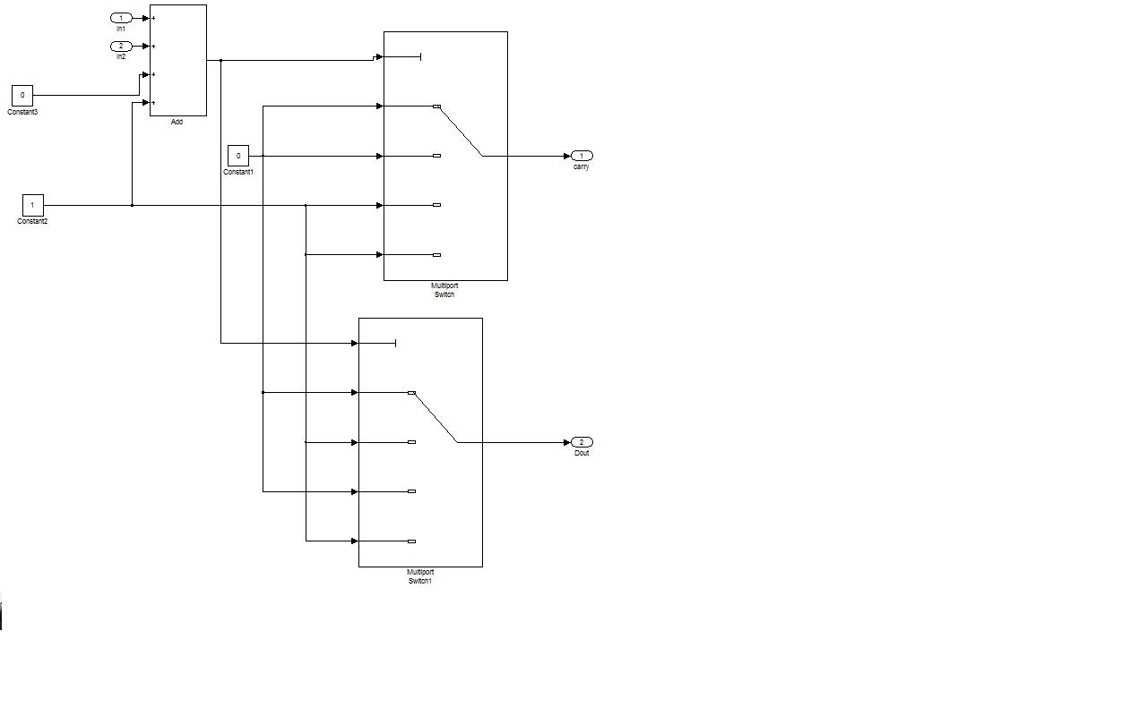

Attached is the schematic for the stage 1 of pipeline ADC.

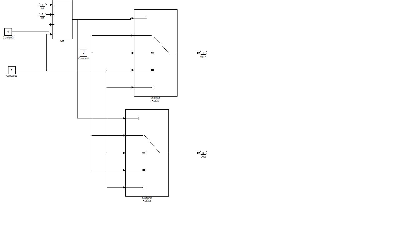

Sorry to provide incomplete information.The input maximum voltage is 0.5 constant.The value for 0.5 after error correction is all 1's.The value obtained for 0.4 or 0.3 is not as required after error correction.Attached is also the error correction block used for this ADC.

I am unable to understand the operation from the schematics. Do you have a block diagram of its operation that you can post?

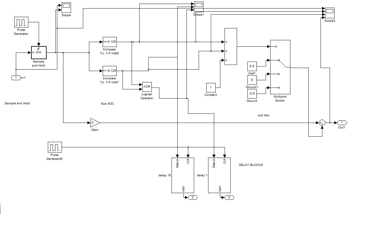

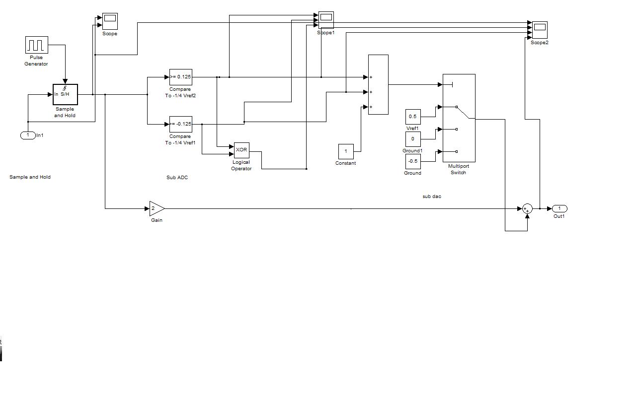

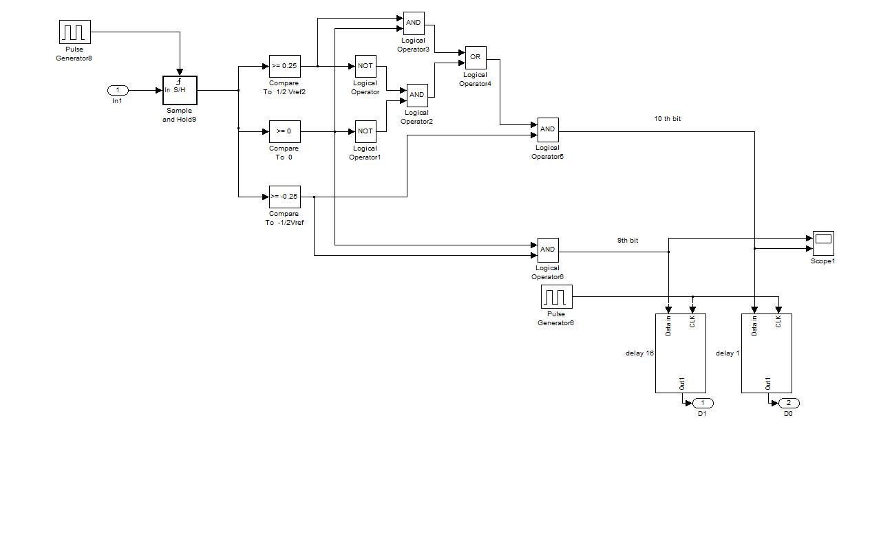

Attached are 3 blocks of the model.The input is given to the PIP_STAGE1 either a sine wave or a dc voltage.This stage consists of a sample and hold,SUB ADC and Sub DAC.The bits from Sub ADC D1 and XOR output are send to the delay blocks.The delay blocks are provide delay to each stage from 9,9 to 1 delay cycles.The last stage of the input stage is a 2 bit flash ADC
The output of the delay blocks are given to the error correction.The 2 inputs to the error correction are from the delay blocks.the 10th bit is not passed through the error correction.The final outputs obtained from the error correction is sent to he scope.
Let me know if any more info is required of me.Thanks a lot once again.

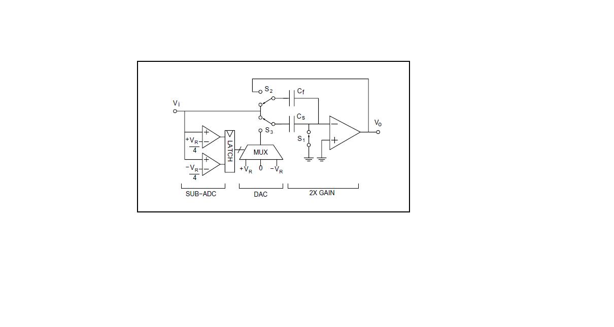

Hello Carl,
Please find attached the schematic for the pipeline adc.This is for each stage.so that a 1.5 bit/stage is produced.

I'm afraid that I don't have time to analyze this rather complex circuit in detail.
Try to follow the signal through the simulation and see if you can determine where it may be misbehaving. Look at each stage and see if it's doing what you think it should at that point.
