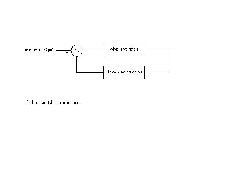

coz i'm going to control the airplane movements by an RF transmitter "27MHz" which is going to be connected to the PC via an LPT..
if u r wondering about the function of the ultrasonic sensor! it's going to be making sure that the airplane altitude won't axceed 4 meters, and the reason why i chose the altitude rang that way, is bcoz i have an altrasonic sensor in that specific distance range!
so if i send "up command" to the airplane, first it will have to check that it's not flying in the 4 m range, if so it will not take the command ..
so the adjustments of the airplane movement will take place in the receiver part, if u want to see the circuit block diagram, it is as the following:

Ok, my bad. Sorry I misunderstood. Seems like you put some thought into this. Now that we have a better picture we might be able to give better answers. Did you get your PC to remote interface working based on Erics suggestions?
Shoot, I shoulda remembered the RC remote, some reason I started thinking usonic link. duh...
Maybe if you keep all project questions in one link so us memory impaired guys can keep things straight :)
OK, looks like you have the easy part (alt) sorted. How do you plan on using the system. Completely autonomous flight, assisted flight (ie: the sensors in the plane must limit the turn radius and pitch angle to a set safety limit?).

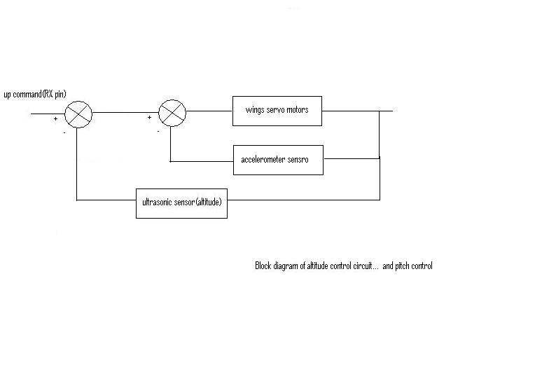

I still don't think you will get anything usable from just the acellerometer alone. If you have a plane with very high dihedral you might get away with only using a gyro on the ussumption that the plane is level if no rudder/ail input is sent to the plane.

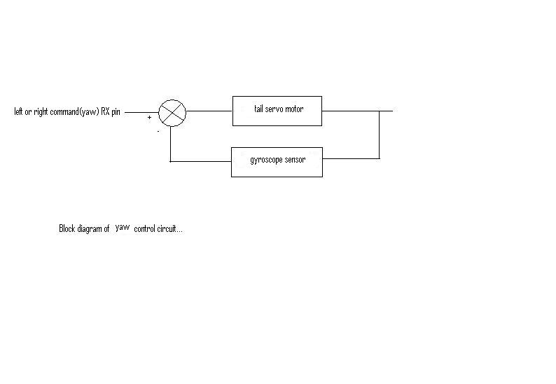

i got ur idea boomslang, and yes that was what i'm going to do if i found a gyroscope , i'll use both "if the God will" gyro and accelerometer IC where every sensor will have it's own circuit like the pics display ,but right now i'm trying the altitude control circuit and if it worked i'll do the rest.
but if i don't have much time i guess i'll control the yaw of the airplane by the rate..
anyway thanx for ur reply, u and mike.

A compass (magnetometer) will not work while the plane is tilted. You do get tilt compensating units, but even these don't work 100% on the airplanes.
btw: The compass will only give heading, you need to take 2 heading readings at a certain interval... do some maths and it will give you yaw rate.

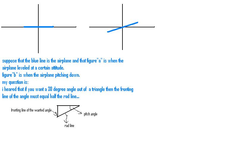

hello everyone, can u plz look at the pic attatched and tell me if what i stated is right or wrong ??
if it's right:
let's suppose that we have a 10 cm fuselage ok, and that the airplane is flying with an attitude of let's say 2m and we send a pitch down command for the airplane, and we want it to produce 30 degree angle of pitch , so depending on the rule whitch says that if we want 30 degree angle of a triangle then the fronting line of the wanted angle must be equal to the half of the rad line so using that would produce the following:
as the rad is equal to the half of the fuselage length then rad =5cm, ok!
and the half of the rad will be equal to 2.5cm right?
so the fronting line must be 2.5cm to get 30 degree pitch angle
and as i supposed above that the attitude is 2m=200cm
then to provide the wanted angle, that attitue must be decreamented by 2.5cm...
so is that right or i'm in the wrong way???
thanx in advance
