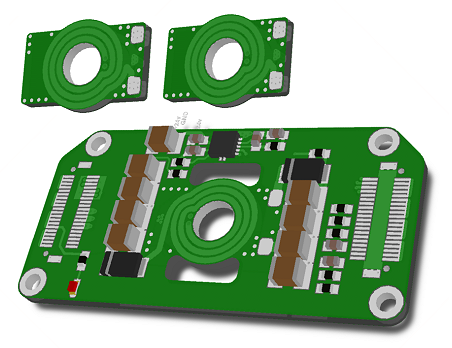

My memory is short and I do not have CAD on this computer. 50 to 75 watts.
I used 4 layers for the power supply with two small break off boards. One break off board goes above the main board and one below.
That is 4layers + 4layers + 4layers.
this is not my design! But much like this.
More in the next post.
More:

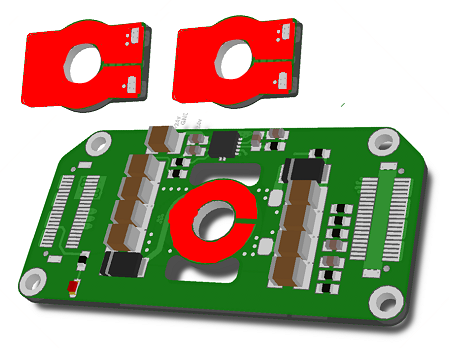

The transformer in #7 has too much copper loss.
Then I realized the core has a very large surface area so the core loss will transfer to air.
The copper loss does not get out well so I change the transformer.
Here we are only getting one turn per layer. Note I brought out the copper, out side the core, to cool off the copper.
With "normal" transformers I try to have 1/2 the loss in copper and 1/2 in core loss.
In planar transformers the copper does not see much air and the core has great surface area.
I don't remember exactly but I think I had 1/4=copper and 3/4=core loss.
