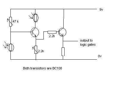

I have designed a light + darkness sensor. It basically is a darkness sensor circuit conneted to a trasistor which is in between the LDR and resistor (this part is ovisouly the light sensor part) providing the potential difference this in turn goes to atransitor which when activated turns on a LED I WAS successfull in getting the LED to light but I want to take an output into a Logic gate circuit.

Right thanks, here is a diagram of my circuit , could anyone please help me I'm using a 9v battery to power the circuit but I have noticed that the voltages coming out of the output are to close together to work when used as an input for a logic gate circuit.
That's a pretty poor circuit, far better to use an opamp as a comparator, have a look at , figure 12.

Thanks Nigel but leave my circuit out of it! Only messing! But I already had a look at that page and I can't understand any of it!! You see I'm building this circuit as part of a school project.So naturally any help on the matter is much appreciated. Thanks anyway with the info. on posting the diagrams.

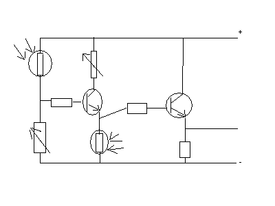

Sorry but I failed to mention what the circuit is supposed to do. You see I need the first LDR (the one on the far right) to ativate the transister when it gets no light shone on it this then allows the second LDR to turn the second transister on when it gets light shone on it.When this second transister is on it allows the electricity to flow out (the output) and Into a LOGIC gate circuit. But the problem I have is that I'm running the circuit on 9v and the output voltages are too close together to operate the LOGIC gate circuit.I am only allowed a max. voltage of 12v. Could anyone please help me.
Try with a lower resistance in the base of the BJT. Could you please include the values on your diagram?
I have to warn you all resistance values are very approximate.

Just by looking at it very fast, I think you'll have to place the resistor (of, say, 10K) in the collector (between 9V and the second transistor's collector), and remove the resistor from the emitter (connecting the emitter to ground).
I don't really get the purpose of the top LDR (between +9V and collector of the first BJT). Maybe you could explain a bit better what u'r trying to do?
Another thing, why going with a common collector, when it's muc easier (and appropriate) to go with common emitter configuration?
