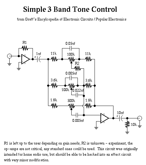

I have a box with 4 speakers- 2 rectangular 4W ones, a square 2W speaker and a tweeter. I want 2 make a guitar amp out of it. I'm thinking of using the LM386(that's what i think it is) 8W Audio amp IC. Now, do i need 2 have a pre-amp stage b4 the amp or just the amp will do?

You need to have a preamp, a simple opamp will probably do, although it's as well to add tone controls as well.
I have a circuit 4 a 3 band tone control. (Attached here)Please see it. I think if i use this there wouldn't be any need 4 pre-amp cuz that's what i think the 1st op-amp does. Tell me if i'm right.

The LM386 has a maximum output of only about 1/2W.
Maybe you are thinking about an LM384.

Guys, could u tell what the value of R2 i the circuit i attached should be? Also, will increasing the value of R1 decrease the gain or increase it. To in corporate a volume control could i put a pot instead of R1 or should i put a separate pot after or before the circuit?
A quick Google search found this one, that looks the same.
Note that your circuit also needs an input resistor and maybe also an input coupling capacitor.
