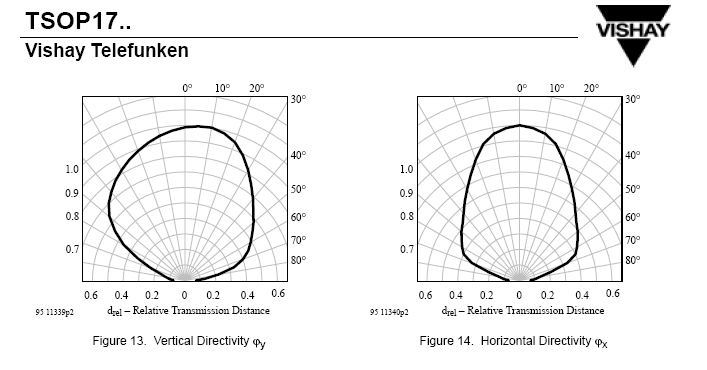

Most IR detectors have integrated lenses which mean that the receiver is quite directional. Can you keep the receiver more-or-less aimed at the transmitter?
well, i think more-or-less is the best i can do. how directional is quite directional? the cage i'm using is about one foot on each side, slightly shorter in height. i can attach the transmitter to the top. if multiple transmitters is a good idea, i can place a few around the sides too. unless having signals come from more than one place will cause a problem.
Here is the directivity of the TSOP17xx right off the data sheet. Looks like it is usable +-70deg from the vertical
thanks, that should work fine then
