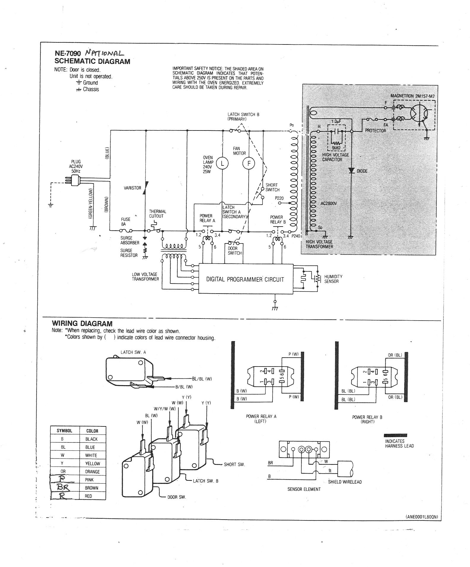

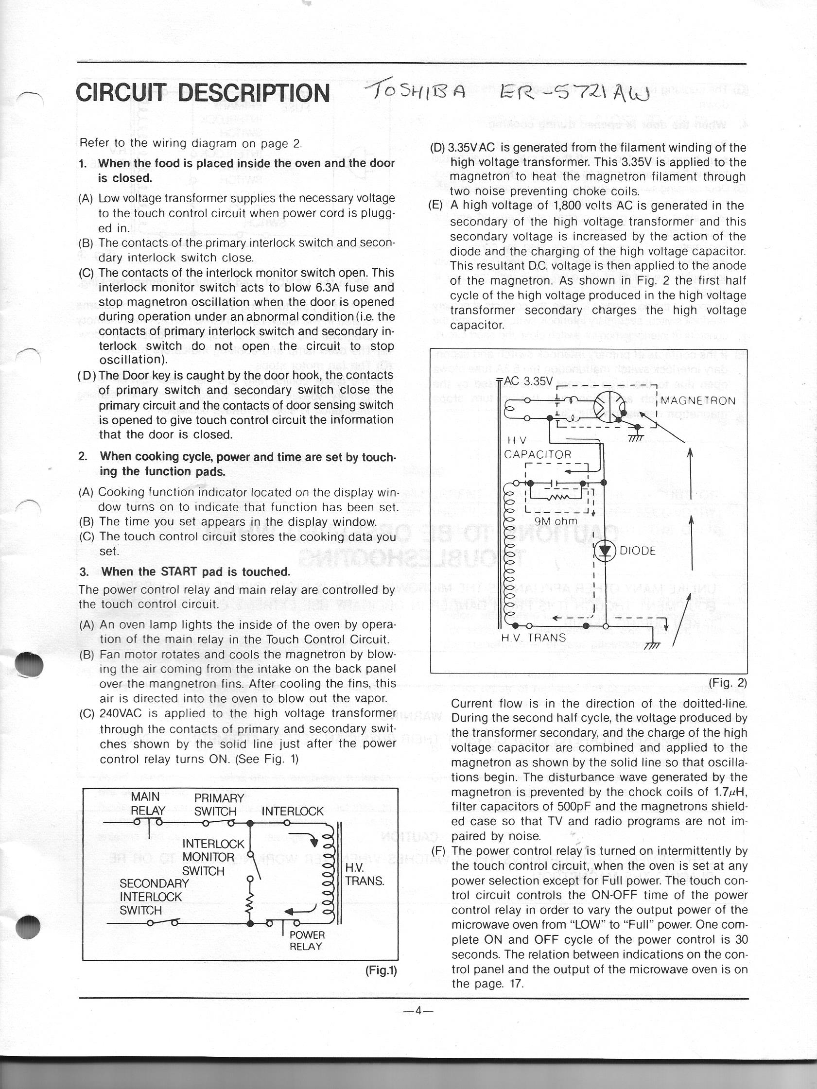

Tracing the primary to mains:

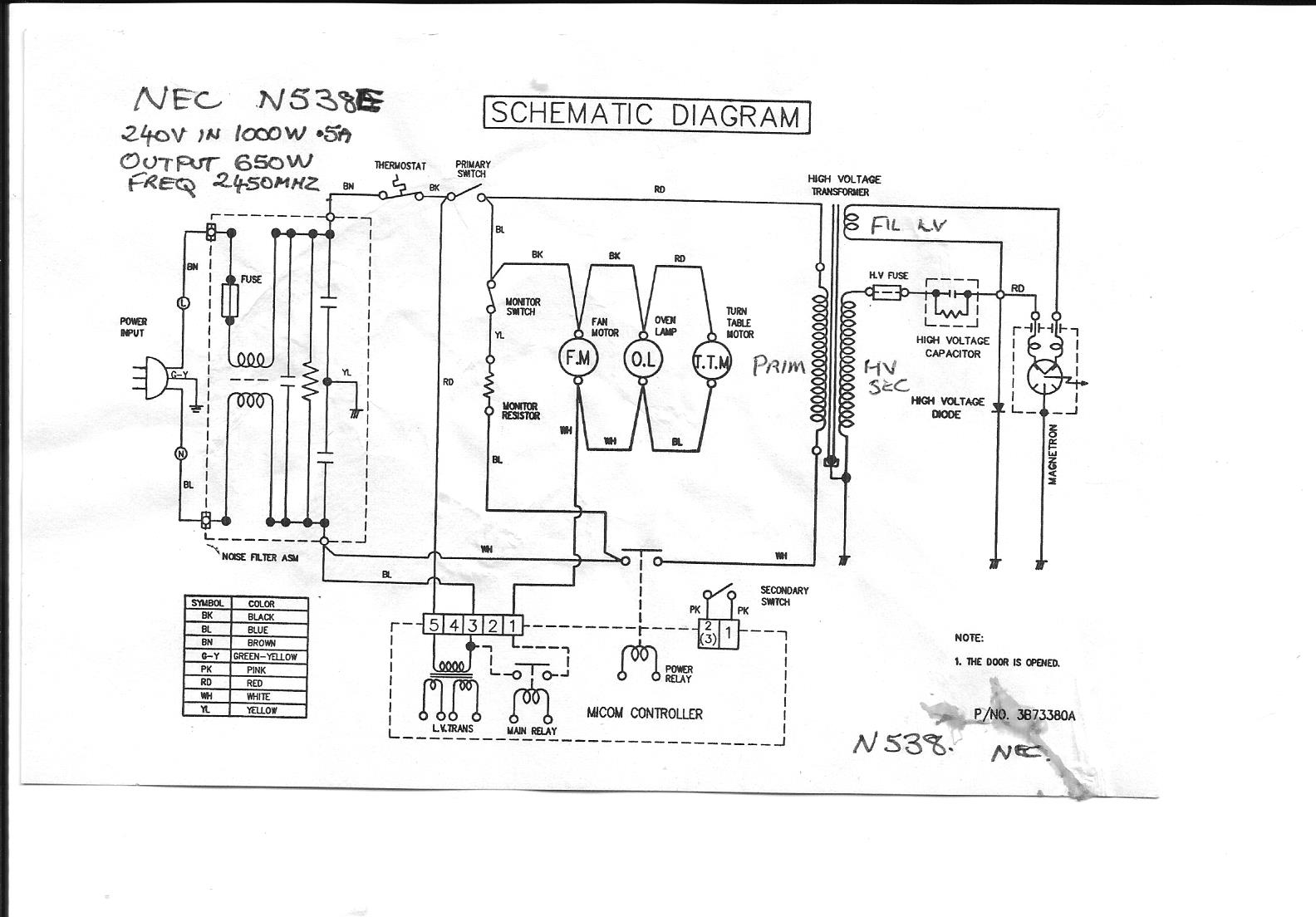

What may be making it difficult is the complexity of the interlocks. There is usually a mains fuse and a NC interlock switch across the mains after the fuse. Then there are two NO interlock switches in series.
you will usually find at least one interlock switch on the door latch, and one or more thermal switches in series with the transformer primary. the door interlock can get out of position and not close the contacts when the door is closed, the thermal switches can fail open circuit. if the door interlock acts indirectly by energizing a relay, the interlock relay can fail.
KISS wrote "There is usually a mains fuse and a NC interlock switch across the mains after the fuse." (??????)
such an interlock would blow the fuse every time you open the door..... most common is a microswitch that drives an interlock relay on the control board, since microswitches that would actually be in the primary circuit wouldn't last long, or they would be expensive because they would need to be rated at 10A.
the most common failures in the primary circuit that keep the oven from heating, are:
thermal switch open no power to the transformer, but seems to be operating normally
interlock switch failed, or out of position, depending on which switch, may not get primary power to transformer, or controls act as if the door is open
control board failure, usually bad relay contacts if everything seems to be working normally except the transformer never gets primary power. you need to listen carefully to the relays on the board.

On page 10 of the service manual I posted in #22, shows the "monitor switch". This switch can short the primary of the transformer if the door isn't quite right and the magnetron tries to turn on. That's the switch I was trying to describe. My head is really hurting today and I probably shouldn't even be posting.
NC normally closed. Or closed when the door is open.
So, if power is inadvertently supplied to the magnetron with the door open, the fuse will blow. Usually the other interlocks will prevent power from being applied.
There were a few other interlock switches too and one that was monitored by the microprocessor.
Although it's not very well written, it's actually true - there's usually two switches which turn the mains OFF, and a third (the monitor switch) which shorts the mains out and blows the fuse if the other two fail in any way.

Please read these notes VERY carefully. They are from a Toshiba Wksp manual & note it is VERY dangerous to measure the secondary voltage of the transformer & un necessary. ( Ive been repairing Microwaves for 35yrs & survived by being well informed & Carefull around High Voltage) Hate to see some one Killed due to not knowing what is involved & not knowing. Ask questions & make sure you understand what is being said. Stay SAFE & alive.
