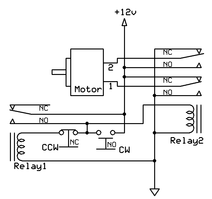

Hey guys im doing a school project and need your help on the electronics side. I just dont get any of it :(
Basically, i'm making a plane which tilts left and right (to emulate air flight). The circuit will drive a motor, which turns some gears, which then pulls down a hook. There are two of these mechanisms on both sides. this is what i need help with:
1. The switch is pressed
2. motor spins for 1. - left wing moves down
3. motor spins for 2. - left wing moves up, right wing moves down
4. this is repeared until button is stopped
5. there is a 5 second time difference between the movements
I have no idea how I could go about doing this. I need to use these components:
555 astable timer
motor
pulley hook thing
gears
Im using the normal components such as resistors etc etc
Here is a pic of what im trying to do:
do i neeed to start the plane on a tilt?
Any help will b appreicated so much, basically i need help making the circuit diagram! Thanks all!!

why have two motors ?
One motor with the "cord" winds left side and unwinds the right side - reverse the motor and right winds, left unwinds.
Otherwise you would have to match the 2 motors relly well or it would eventually pull the wings off.
The circuit is reasonably simple.
Push button - plane tilts back and forward with a 5 second "swing time" and continues to tilt from left to right until the button is released
So you need 2.5 second forward motor ( tilts plane to left down.)
then a 5 second reverse (tilts plane left comes up 2.5 seconds, right goes down 2.5 seconds)
then a 2.5 second forward motor to end up back at the start - plane level.
If button is still presed then start again.
You would need to work out the pully ratio to get the desired effect for 5 second on time.
Than deciding the swing in seconds you better limit the swing by some limit switches on the string both sides, variable motor speed drive can adjust the swing time.
also one motor with a mechanism can work better
to implement push button on-off (for touch switch) use a flip-flop IC.

Do i have to use a DPDT switch? I've read about them and im sure i can use them in this project
Edit: I think im going to do two circuits. one for each motor. that way it is simple and it will work (hopefully), although if i do it like this the user would have to manually alternate between the switches when pressing them.
Ok i have an idea which i think may work. tell me guys
i'm only gonna use one motor with a DPDT switch. There is going to be a reed switch connected to it with a magnet on the wing. So when the wing touches the reed switch the motor will go the other direction (by the means of a dpdt switch). There will be another reed switch on the bottom too which would make the motor spin the other way so the wing moves up
Is this a plausible idea guys??? really need help fast
With a couple of relays and a couple of limit switches, this should work.
Ken

It would be difficult to do automatically with DPDT "switches" as they require a lot of force to switch them...that's the reason for the DPDT "relays". Do you have access to relays for this project? Do you understand how relays work?
Ken
Ken
yes i have acess to relays, i sort of know how they work but not in the context of this project.
great, i really thought dpdt switches were gonna work on this one :(
