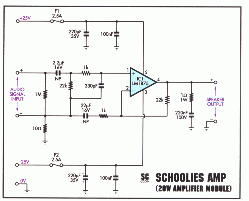

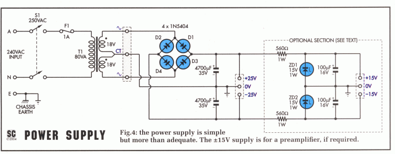

Hiya Thomas,
Below is the schematic of the schoolies amp and a suitable power supply. If you like I can send you the circuit board pics along with a description of the circuit via pm.
Hope this helps
Cheers Bryan1 :D

Ohh my god thank you sooo much. i handed my project in a few days ago and i got an a on it...thanks to your help. you wont believe how happy i am....thanks again
Thomas :D :D :D :D
