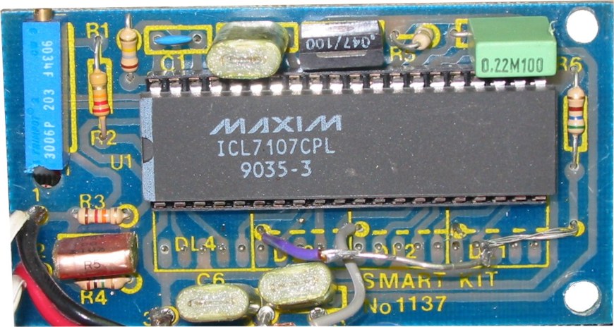

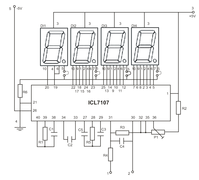

Please help me measuring AC voltage with this VOLTMETER
I want to measure household voltage...that is about 200V - 250V AC
I saw this project with the ADC IC ICL7107 here
but the problem is this measures DC voltage....
Please suggest me how will i measure the 250V ac current....???

In that case you will need a supply for the DVM module, +5v and -5v from a quick look at the attached circuit.
You can do this using a transformer and a couple of rectifiers, capacitors and 3-terminal voltage regulators.
Then you will need a second transformer to provide an isolated signal to measure the voltage, a rectifier, resistors and a capacitor to convert the AC to DC and filter and scale the signal to the range of the basic DVM.
