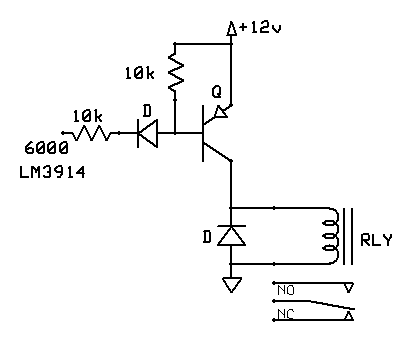

Try this
Hi Ahonda,
The transistor circuit from Fried won't work with your tachometer circuit.
Your relay coil draws only 38mA so if you re-wire your tach circuit to be a "speed switch" then the 50mA-rated driver transistor in your LM2917 can easily drive your relay's coil directly, without anything else!
