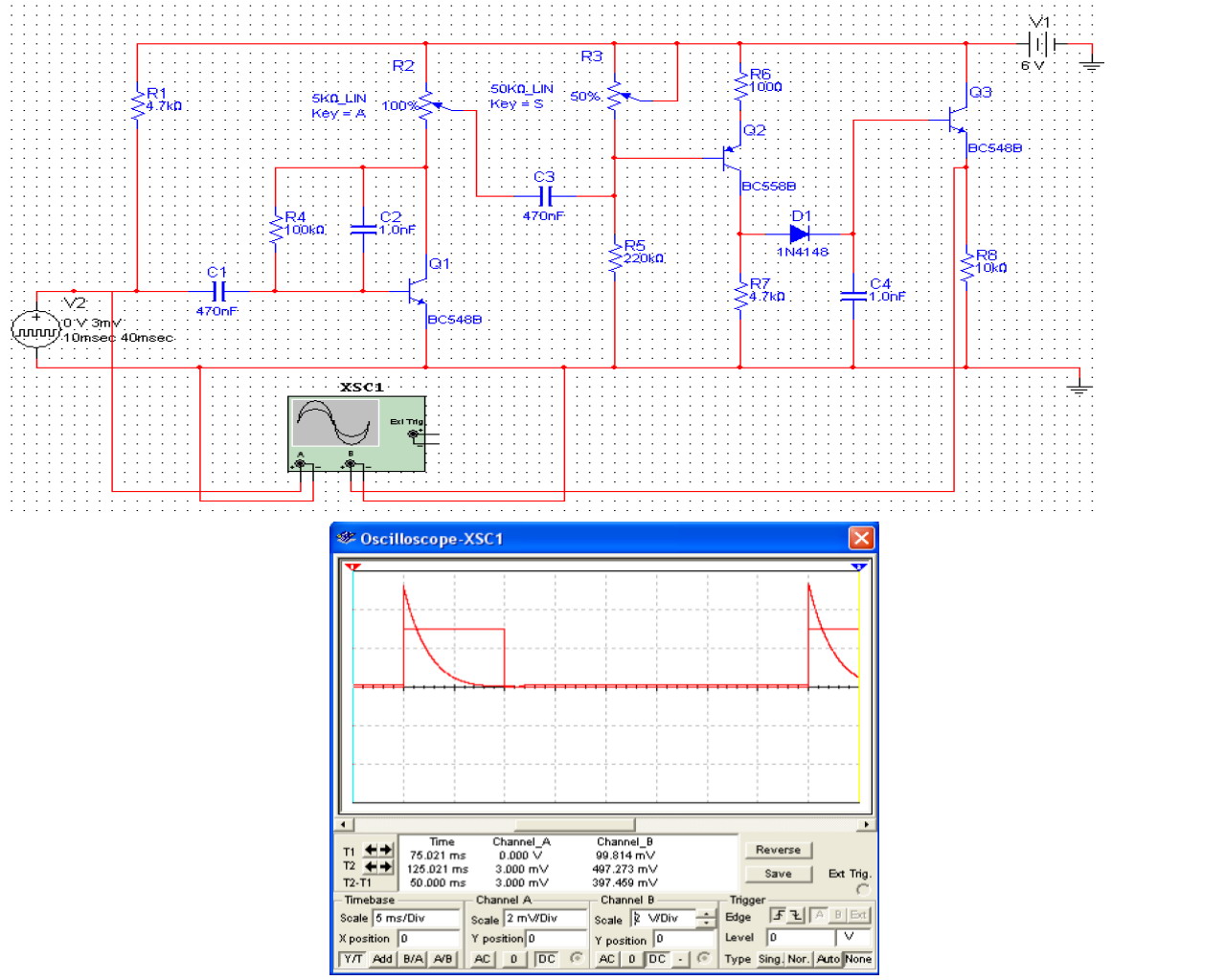

i'm having problem with my circuit shown below....
that's a hand clapping circuit and i need help on the circuit...
i've replaced the eletrec mic with the pulse voltge becoz i can't find and mic in the multisim software...
when the pulse is triggered, the output rise to some peak value as shown...
my problem is y the output voltage won't drop till 0V?
the output still maintain at 2V++ even though there's no pulse triggered??
anyone pls give some suggestion and help me with this curcuit,...thanks

They won't drop to 0V, but to a close value.
On the essence, your apparatus is working.
Maybe Q2 is not correctly biased.
Maybe Q3 is not correctly biased as well.
I think R5 value (100 ohms) is too small for a transistor like BC548 (Q3), you should add another resistor on Q3 base.
R2 is at 0 ohms.
Hi, chyun
Before the experts get in here and muddy things up, I suggest you remove the capacitor C2 and resistor R1 from your circuit, and see what happens.

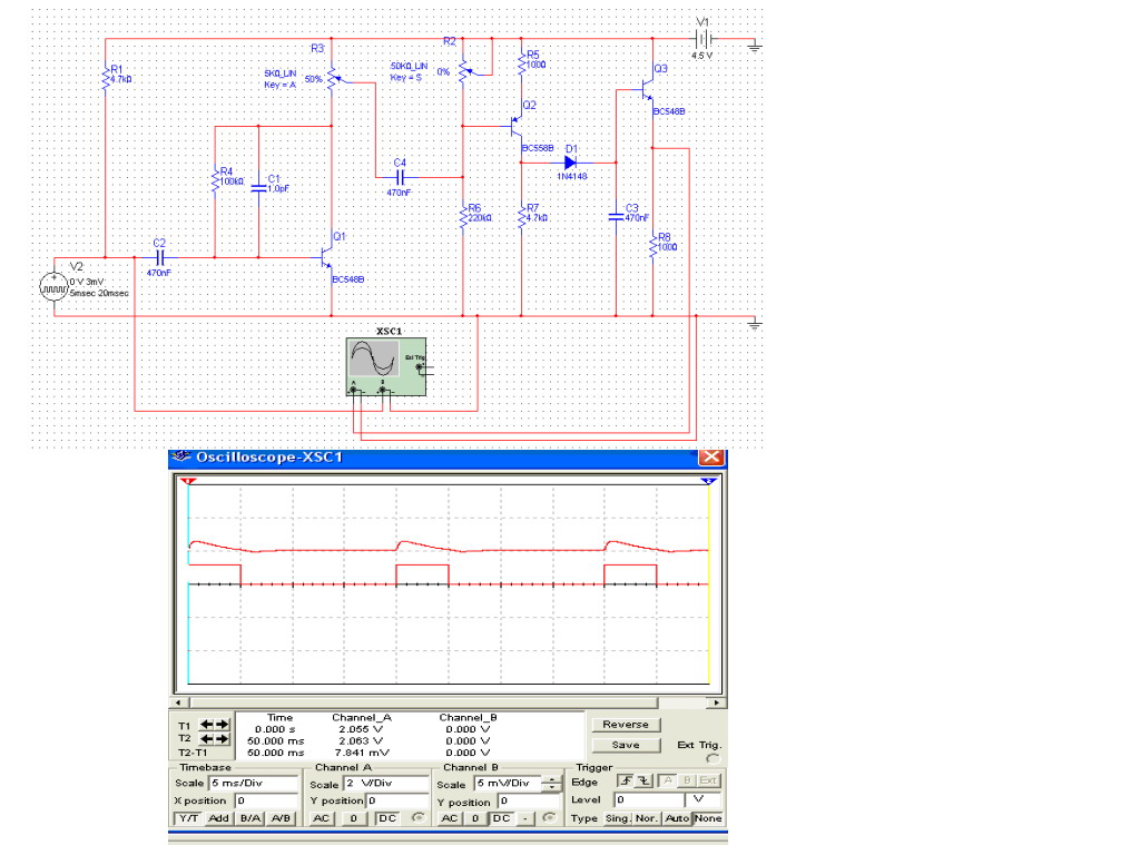

after several of modification, i change some value of the components and i get the output as shown....
i also changed the supply voltage from 4.5 to 6v
but i got few questions..
- izzit my circuit ok for now?
- can i connect the output to my pic16f84 microcontroller?
- is the output voltage enough for the input of microcontroller?
- any modification of the circuit i need to do??
pls give more suggestion thanks....:)
Looks like you have 5VDC out. If so, A 5volt PIC can read that. Maybe a current limiting resistor or diode if you are worried, and check it with a meter on a breadboard. What are you working on? The simulation shows 2 V/div on trace B from what I can see.

oh ya.. by the way.. just now u mention about the 555 clapper switch, izzit this one?? **broken link removed**?? izzit suitable for my project?? how much its output voltage??
do u think my circuit works fine?? i dont feel like to change if mine one works well..:)

That is the one, it will work fine. But like you, if you did all that work, you learned and had fun (most of the time). I would keep my circuit too.
Have you thought about a zener or something on the input (pin0) I think it
was in the software.
