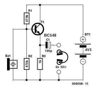

I was actually experimenting with this circuit last night. Well, by that I mean it was late and I just threw it together but it seemed to work pretty decently. I used a piezo (which I still find to be awesomely sensitive). The cool thing I thought about this particular circuit is it's minimalistic design. You should check it out, and with some tweaking might be a good starter for what you need. :)
A piezo transducer is stiff so it has a high audio frequency resonance where it is most sensitive. It is not sensitive to low frequencies.
Your transistor is an emitter-follower with no voltage gain and it is overloaded by the headphones.
So what can it hear?
Actually, yea, good point Audioguru. I didn't tinker with it much, but I just tapped it a couple of times and I could hear it. Not as sensitive as when I was working on a guitar amp, though. I guess that wouldn't work as well when used as a heartbeat monitor.

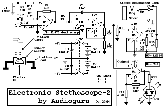

I heard my heartbeat loud and clear with this circuit that was on two other websites that didn't work until I fixed it. I used a plastic lid from a jar to hold the mic and used over-the-ear headphones to avoid acoustical feedback howling.

Oh yea! I was checking that circuit out the other day. Do you really need two 9-volts? And what's up with the shielded wire? Is that essential?
Lol If I were to pull my heart out, I would think at that point I wouldn't need to hear it...I just went from audio to visual :p then a few seconds later I die...
The minimum voltage for a TL07x opamp is 7V and a little 9V battery quickly drops to less. A 12V battery can be used instead if the opamps are re-biased for a single-polarity supply.
Yes.
There is plenty of gain and if the circuit is anywhere near civilization then unshielded input wires will pickup a lot of mains hum.
