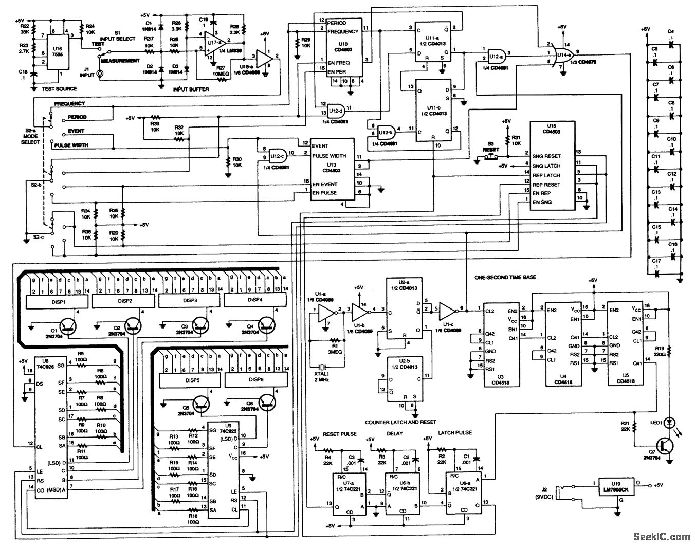

please help me, anyone have the original circuit and descripton, i think in the frequency mode measurement error in the circuit.

what, exactly did you think is an error in this schematic?
there was a circuit diagram there on monday morning..... then the board was updated and it went away.... it's a cmos or TTL frequency counter, and i don't think the OP realized there was a ganged rotary function switch, and was just looking at the first layer of the switch that had the frequency and period contacts tied together.
